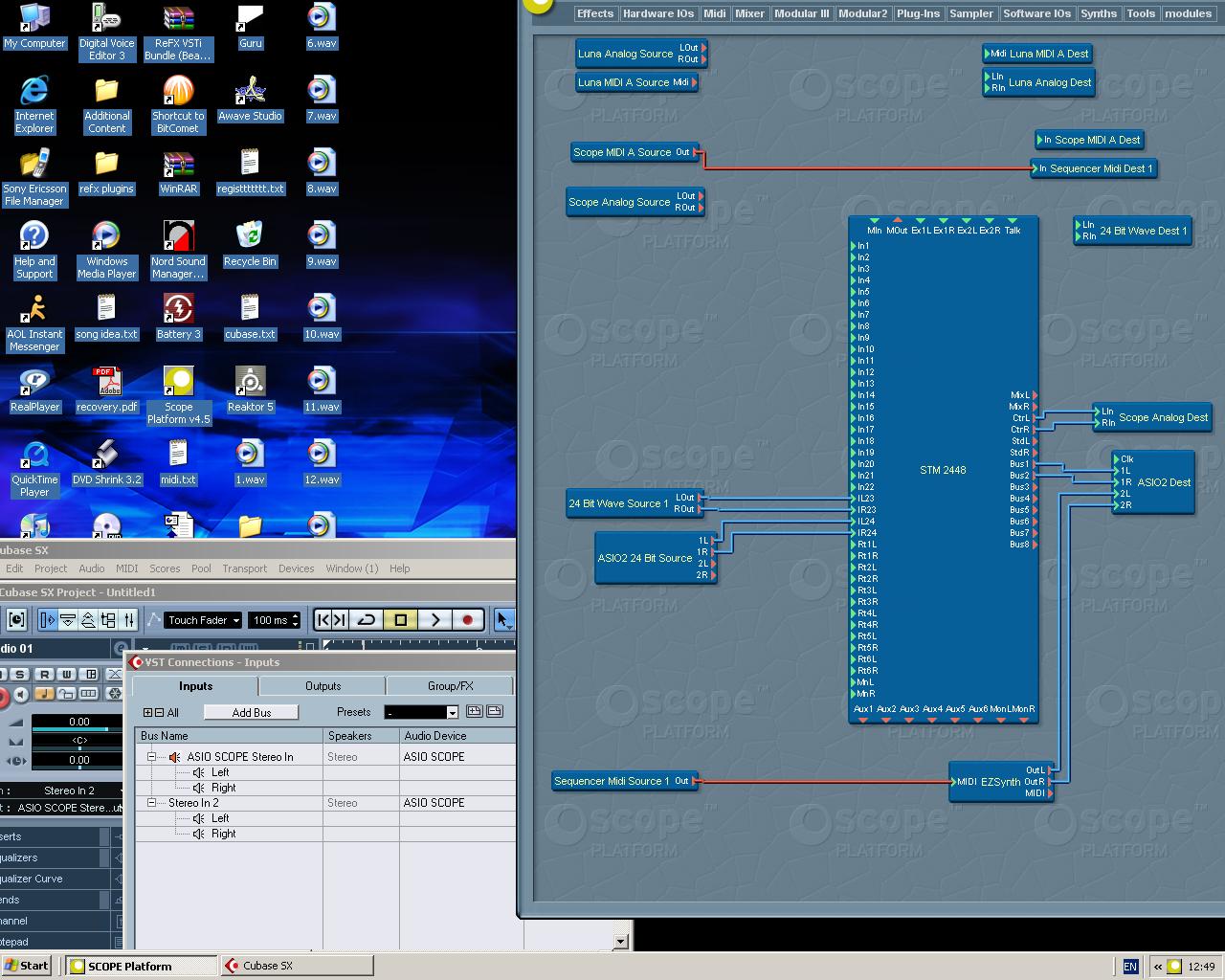

sorry im still not getting any sound for some reason. heres a screen shot so u can see whats wrong. btw all my equipment is connected to scope card not luna, thanks again stardust

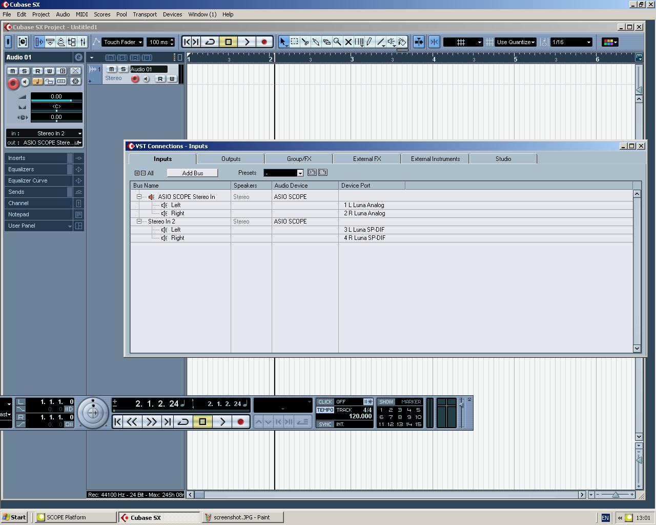

what i did was add another bus to the vst input

it works :D thanks so much stardust if i could see u id kiss u
