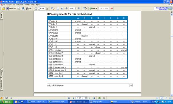

I have just bought the P5Kdeluxe. ( also with Intel Core 2 Quad Q6600 2.4GHz and 4g Ram). Received it today but cant test it with my scope system as I am away from from my studio for 2 more weeks. But reading the manual I am a bit concerned about IRQ issues. Seems like the PCI slots shares with SATA 1 and 2 and various other essential bits. But then again; I have never quite understood the ASUS IRQ sharing form... Can anyone confirm or explain?

Page 2-19 on your ASUS P5K DELUXE manual has the default IRQ assignments for the motherboard. Looks like #9, #10, and #11 will get used by default.

But I am wondering how to understand the next form on the page ; The "IRQ assignment for this motherboard". Thats where I see potential issues...

there are levels to those charts. as you add devices, sharing occurs. if you have turned off most unneeded ports you'll likely be ok. at what level does the chart show sharing? first, second or third? if it's first, don't use that slot unless you have to. i have had to allow sharing with a sata controller in the past and the machine ran just fine, so it's not to end of the earth, necessarily.

Thanks Garyb! Here's a picture
I guess horizontal A would be what you call 1'st layer and onwards...?!
If this is the case, then with my 2 scope cards setup the best thing would prob be PCI slot 1 and 2 (turn off Lan and hope Sata controller 2 dont give any hassle). And then 'praying to the aliens"...
oohh almost forgot..Hub...Thnx for your insightful input :wink:

that's correct.
