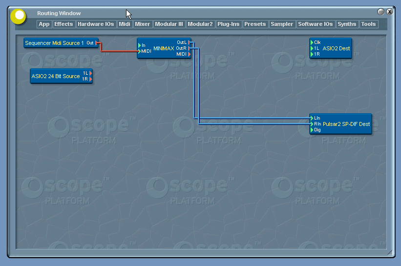

Setup attached. It worked before, it's my autoload or whatever Scope calls it.
My Scope startup project
Picture 1.png (76.53 KiB) Viewed 1591 times
Posts: 23398
try adding a sequencer midi dest as well. (there's none in this screen shot)

is there still no sequencer midi dest in the project?(it needs to be there BEFORE opening midiox) :D

garyb wrote:is there still no sequencer midi dest in the project?(it needs to be there BEFORE opening midiox) :D
Yeah, I put these in there then relaunched MIDI Ox. Many times. :)
