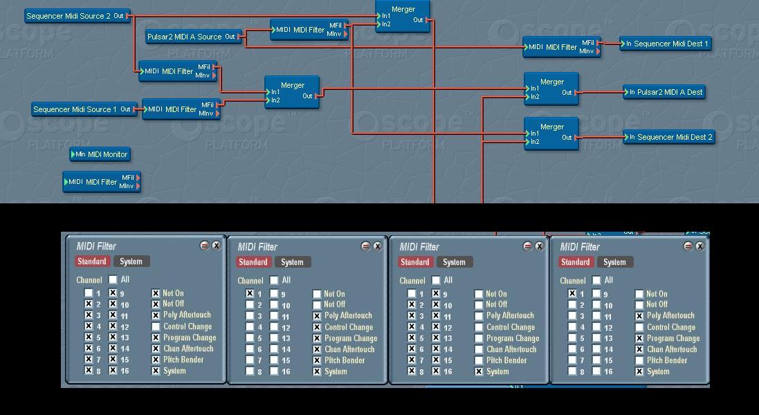

One last thing, is a SFP routing example. I admit it gets kind of complicated, routing MIDI signals around so that every base is covered and there's no feedback loops or doubled messages, etc. As far as I can tell this routing setup works stably. This allows me to use Cubase to automate a Scope 2448 mixer, and also incorporates a automated hardware mixer (Behringer 3216) at the same time. The top picture shows the SFP connections, and bottom picture shows the settings of each MIDI filter, from left to right. The mixer receives and transmits on channel 1, which lets you use channels 2-16 for other things (like triggering outboard MIDI gear).

Thanks so much for postnig this! I tried a while ago to work something like this out for samplitude but I could not get rid of the midi feedback issues. I'm not so good with midi stuff yet. Im just a dumb skin basher. :D
Anyway, this works great with Samplitude as well. In fact I found that in samplitude I dont need to create seperate tracks for each channel I want to automate. I just use the vst automation curves in each track. Way easy!
But I couldn't have figured that out without your post working me thru the midi feedback issue.
