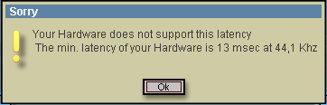

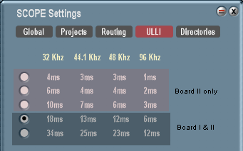

I have read some post in the "scope purchasing" that show that people do not know how to determine for sure if they have Board of generation I or II.
The easier way to determine for sure wether it is I or II is the ulli and samplerate it can deal with.
Board I lowest latency is line 2 (from bottom), whereas all latencies are available with a board II. Also Board I cannot do 96 khz sampling. There are also other differences, but harder to quantify, or not essential ones.
In the pictures, "board I & II " refer to board of generation 1 and generation 2. generation 1 was released in 1998 and replaced by generation 2 in year (... 2000 ? not sure ).
PS, a little mistake in the ulli picture: a board I cannot do 96khz (it can do 32/44/48 only i think).
Board 1 trying to set too low latencies

which latency for which generation of board :
