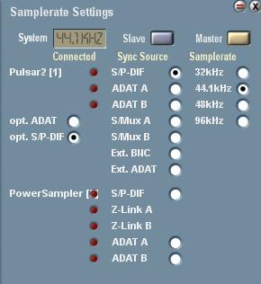

Astroman, thanks for your response. When only Luna is installed, ADAT devices are shown (ADAT A, ADAT B). When I install both cards, ADAT is shown only from Pulsar card, and ADAT devices from Luna hardware dissapired. Strange....

did you try to make sure that the cable from the expansion plate is still well connected after you add the pulsar.
as adding another card should not make a plate disappear. that is strange
did you try reinstalling the software so it detect All I/O
you should see something like this
sample rate.jpg (13.24 KiB) Viewed 1718 times

Yes, what is most strangest, I see just picture you sent, in samplerate window I can see ADAT physichaly connected, but in hardware devices, there is no ADAT devices for Luna :-?
