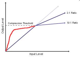

okay most recent compressor design are based on the classic layout, with treshold, attack and release, this seems to be the ordinary and classic way to achieve more loudness from a fixed headroom ...
Yesterday I though about why there are no new approaches to reach that goal...
Especially with digital information....
All compressors I know so far work like shown in the following picture:

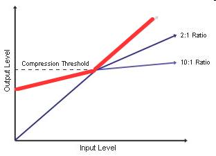

But in general I think it has 3 main bad components:
(1) pumping at heavy compression setting and lower treshold levels....
(2) signals below the treshold get the strongest "relativ" boost
(3) headroom loss due to heavy compression and normalising process in digital world leads to quality loss (okay not big)
after normalsing the compressed signal should have a curve like this:
right?
I thought some time about this and came to the conclusion that it should be possible to do a more satisfieing compression algorithm design for an even smoother sound result:
I think this would have some main advantages:
(1) smoother compression over the whole dynamic range, not only in the upper range
(2) no more need for attack and release parameters, as there is no hard cutting treshold line
(3) no headroom loss if correct programmed
I`m not sure, this may be compete bullshit, but im interested in some other opinions...

That looks like you´ve described the knee caracteristic, to make a compression sounds more musically. Soft Knee Hard Knee.
The soft knee puts ,allow me to say, a slope on the compression curve, like a knee looks.
There is a work around to achieve a more musically compression.
For example, if you want to get a compression of 8:1, try to use more than one compressor.
You can use three, each with a 2:1 compression.
This work around is called multi knee compression.
Test it!

bosone
Posts: 1530
Location: Italy
Post by bosone »
what about this kind of dynamic processor device?
does it exist?
what is its name??
and, most important of all, would it be useful?? :-)

hifiboom
Posts: 2057
Location: Germany, Munich
Post by hifiboom »
this wouldn`t work because you can`t transfer levels at 0 to higher ratios... your red line always ahs to end at 0.
