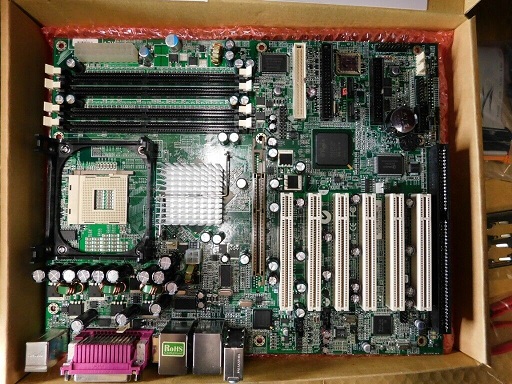

Just built another XP machine to run scope and it's been amazing.
BCMCOM Motherboard, Socket 478
P4 3.0
500 watt PSU
4 GB ram
GeForce FX6200
240 GB SSD
Been running great for past week, and I just added another Pulsar card. 8 DSP's of fun, no complaints. :)
Also, those motherboards are available still, NEW, motherboard/CPU combo. I found a seller on ebay and it was $120.
It has:
1 AGP
6 PCI
1 ISA
The ISA and 6th PCI are shared.
Posts: 7757
Re: Definitive Scope PCI card host PC?
Nice looking board.
Posts: 8466
absolutely - didn‘t know there were P4 boards with ISA slots... so thank you @PlanetZaxxon .
Just browsed the manual and it seems a better alternative than the old Asus P2/P3 boards on my target list to eventually get the HardSID Quattro (ISA) up and running. It’s been sleeping for ages in it‘s box on the shelf.

Yes, me either! this was the first I have come across I believe, P4 with ISA slots. I love ISA slots, for some Sound Blaster 16 action, heh.

PlanetZaxxon wrote: Tue Mar 23, 2021 4:43 am
Link ?
Which RAM does it support ? RAMbus ?

It is the standard SDRAM, DDR400. 1GB max per slot.
Just shoot an offer for $120 and he will accept.
