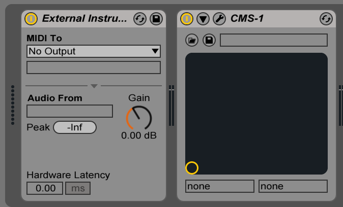

No fuss! It didn't work this way until we made the release yesterday! Now you can run the CMS-1 plugin in a chain after External Instrument in Ableton, so you can have a single channel to handle both the MIDI to Scope and control the CMS-1 Scope device.
Screen Shot 2018-06-23 at 19.44.30.png (46.86 KiB) Viewed 47277 times
(this is Ableton running on OSX btw, hence not having a Scope MIDI output )

looks like you have no Midi connection?
The CMS plugin works as an audio plug-in.
In Ableton, you can send Midi either by using an External Instrument, as Will described
(for 'MIDI to' click the respective Scope Midi input)
-or-
you can just create an additional track with Midi going to Scope.
