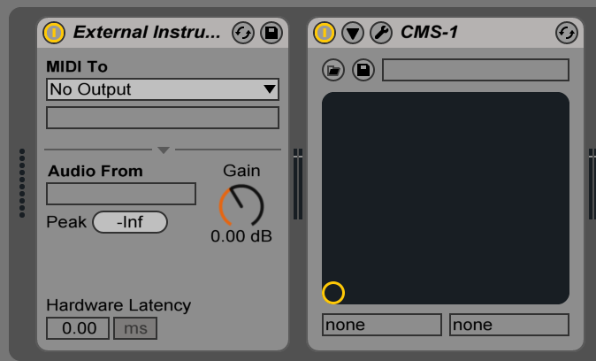

petal wrote: Sat Jun 23, 2018 5:10 am Ahh, yeah ok I see. Sorry about the fuzz :)
No fuss! It didn't work this way until we made the release yesterday! Now you can run the CMS-1 plugin in a chain after External Instrument in Ableton, so you can have a single channel to handle both the MIDI to Scope and control the CMS-1 Scope device.
Screen Shot 2018-06-23 at 19.44.30.png (46.86 KiB) Viewed 47170 times
(this is Ableton running on OSX btw, hence not having a Scope MIDI output :) )

Finally got around to installing CMS-1 this evening. I first installed scopesync-v0.6.0.62 and also ScopeOSC-v0.1.4-beta then installed CMS-1 v0.1.0.62. During CMS-1 install I changed the location of where to install the CMS-1.dev to C:\Program Files\SCOPE PCI\Devices\Synths\Third Party\CWM since it follows my Scope folder structure, but the rest of the paths I left as default.
After reboot I started up Scope 7 64bit and on loading CMS-1 into routing window and then selecting Show Panel, the CMS-1 panel shows fine. And if I open the presets window and select Noodles Bank, most of the presets seem to work fine, and I am getting some interesting sounds and patterns. So that seems to work ok. However many of the presets dont seem to respond when I play from my MIDI keyboard. For example if I go to preset bank called Synth, none of the presets work for me. Also in Tutorials bank I get no sound from the presets there.
Could this be due to a missing module or some other file. Or could it be a problem with the latest version scopesync-v0.6.0.62 which was just released 4 days ago according to github.
If anyone has an idea why I cant get any presets to play via midi input, I would appreciate any help. Thanks
roy thinnes
Posts: 651
Location: Graz
Re: CMS-1
Post by roy thinnes »
looks like you have no Midi connection?
The CMS plugin works as an audio plug-in.
In Ableton, you can send Midi either by using an External Instrument, as Will described
(for 'MIDI to' click the respective Scope Midi input)
-or-
you can just create an additional track with Midi going to Scope.
