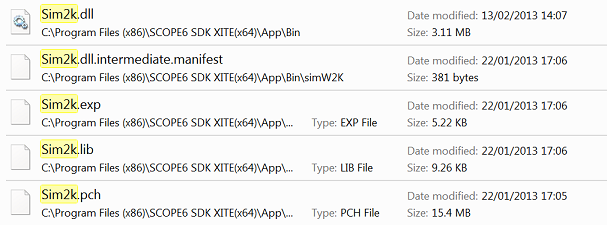

Hmm, I checked and I certainly don't have a sim.dll now anyway. Here's what I get when searching for sim2k, which looks similar, although not identical, to what you have.
Either way, it's working ok for me now but wasn't at some point and isn't working for others. Mysterious!
