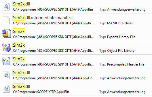

no reboot or whatsever_
sim2k.dll is in app/bin folder as well as in app/converter5_1
what does a search in explorer vibes tell you?

But note that the error displayed is "cannot load sim.dll", not sim2k.dll
