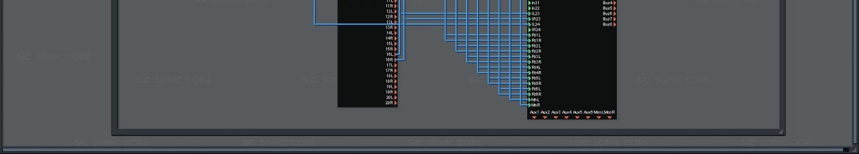

maybe you could make a screenshot of the routing window while the non-working adat port is being tested....

The faulty "scope Adat A" is in the same place as "Side" here, which has output to Pulsar2 Adat A. So they should have the same output. And it doesn't work.
If I use Pulsar ADAT B, it works too.
It's not the same set-up as the other day: I got all aux through a second table, which is in charge to output samplitude and manage earphones and live monitoring.
Posts: 23388
Re: Maximum distance for ADAT/wordclock
judging from what you have told me and what i can see, not too much to do about this, i'm afraid....
