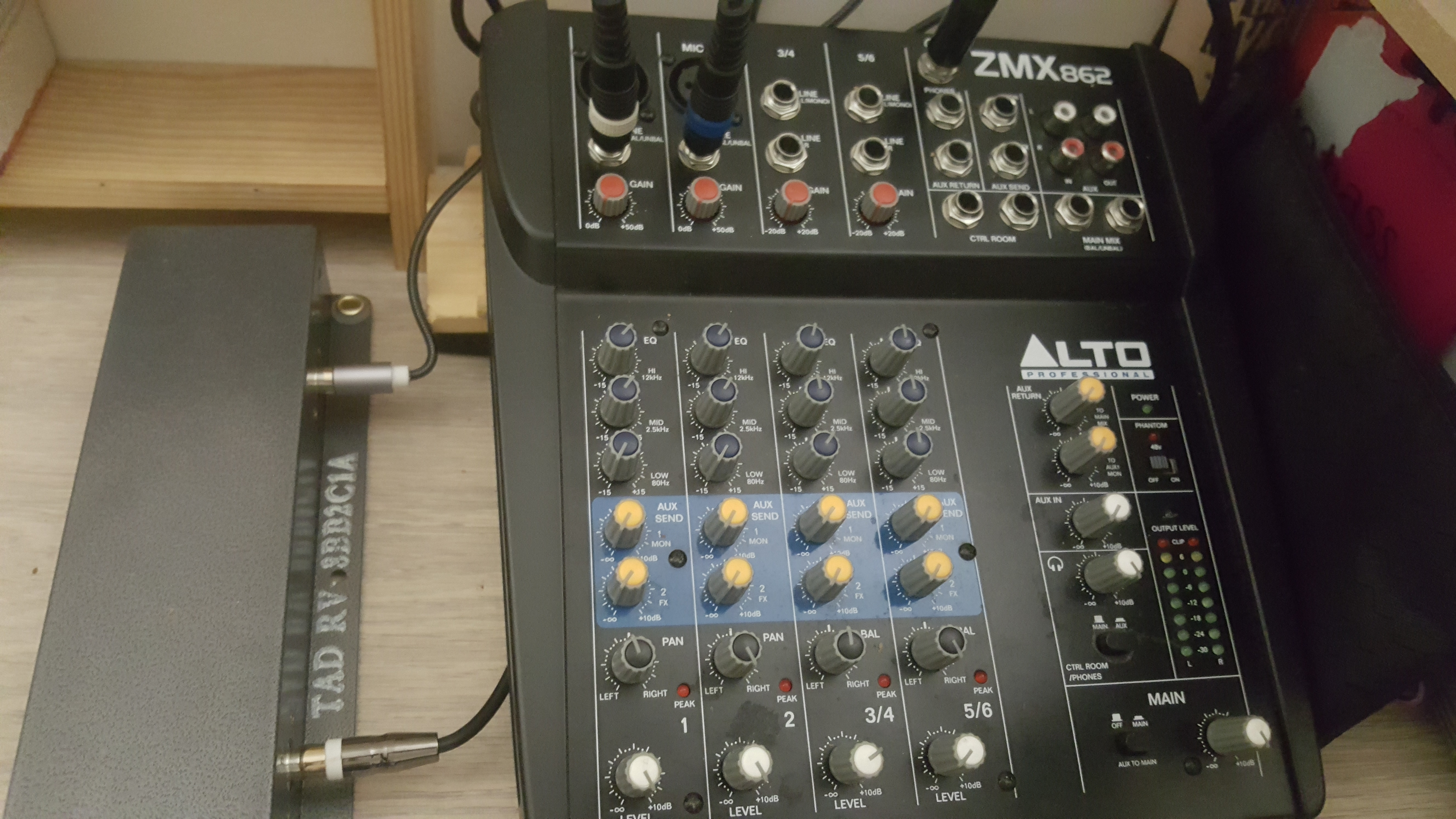

Ok, at last, 1 year later,  here is my rig for a Spring reverb on line outputs.
One can use headphone output of Xite to send directly to a spring reverb,
Here are two YT tutorials about that:
https://www.youtube.com/watch?v=CXJdSREWxxY
https://www.youtube.com/watch?v=vIryyi3bp-c&t=1s
but I need the headphones out, to use headphones, so I needed to use Line I/Os to save the headphones out.
Problem: headphone amplifiers are not made to be plugged on Line outs (they just extend the headphones output). So it is useless if one needs to use Line i/os (except more expensive models probably).
- I got a second hand mixtable (alto ZMX862) with most outputs @ 120 ohms, including headphone output. So it is like a headphone amplifier with extra functions. I can feed it with line level signals (you can't do that with headphone amplifiers).
- The Spring is BB type ( 150/190 Ohms input /// 2575 ohm output)
- The Spring goes to a HiZ input of Xite with RCA to TS cable.
cost: 40 € second hand mixtable + 30 € spring (NEW) + 18.50 DHL + 9.99 2*RCA to TS" cables = 98,49 €
You could add another tank and use PAN to route signals to one or the other or both, in dual mono or stereo.
that would be around 150 € for a dual spring setup.
One could add a DI box to convert the HiZ from the Spring into a Line signal (a dual box for stereo).
Voilà, problem solved, sounds better than IRs Will allow to turn many Scope Delays into proper "EchoVerb" units.
Made me think that of SOnic Core ever does another card, it would be incredible to have spring i/os to use them directly .   (lol, that would be unique)

Hello,
I wanted to add that I got a DI Box but it did not work (output is 600 ohms mic level, but it was weak as hell, probably faulty or made for something else). So I returned it.
So far only HiZ inputs worked straight away, as well as my old Mooer Radar pedal that is line compatible (but the price is not really worth it if it is bought just for this - aventhough it IS cool to add cab sims to the spring tank, it changes a lot the character of the spring).
I found Harley Benton MiniStomp Magnum D.I. 19.90 euros , it has good reviews in terms of sound. Then, there are a lot of amp sims with DI outputs, but they are more expensive (the TC electronic amp sims).
In the video tutorials, the guy uses an Accutronic which outputs at 600 Ohms, plugged into a MIC input.
So the choice of tank depends a lot on the available in/outs and the extra gear that you may already have (or in which you want to invest).
let me know if you know a DI that converts HiZ into true Line input (not MIC) and which is not expensive.
I think there are preamps that can do this, but I think I am done with my setup (all on HiZ) so I will not investigate much further right now.

Re: will this spring reverb work as an aux (impedance/RCA)
Here are some pics of my final setup.  I also made devices for them fo Scope/Xite, that you can find
here viewtopic.php?p=356852#p356852
or there https://spacef-devices.com/free-downloads/
They are Send/Returns tailored for mono effects. Fully tested with the pictured setup
Sounds really great like that...
