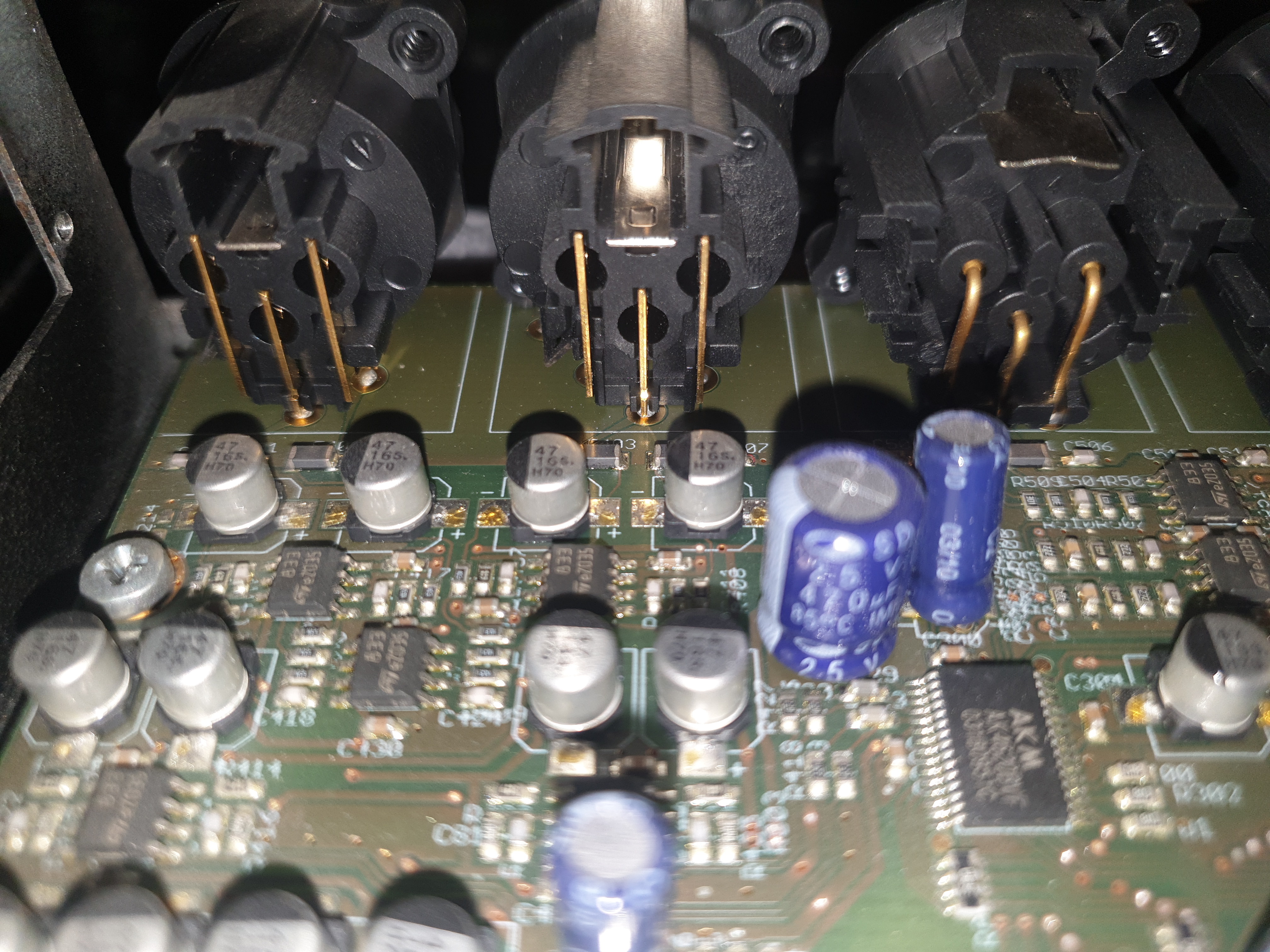

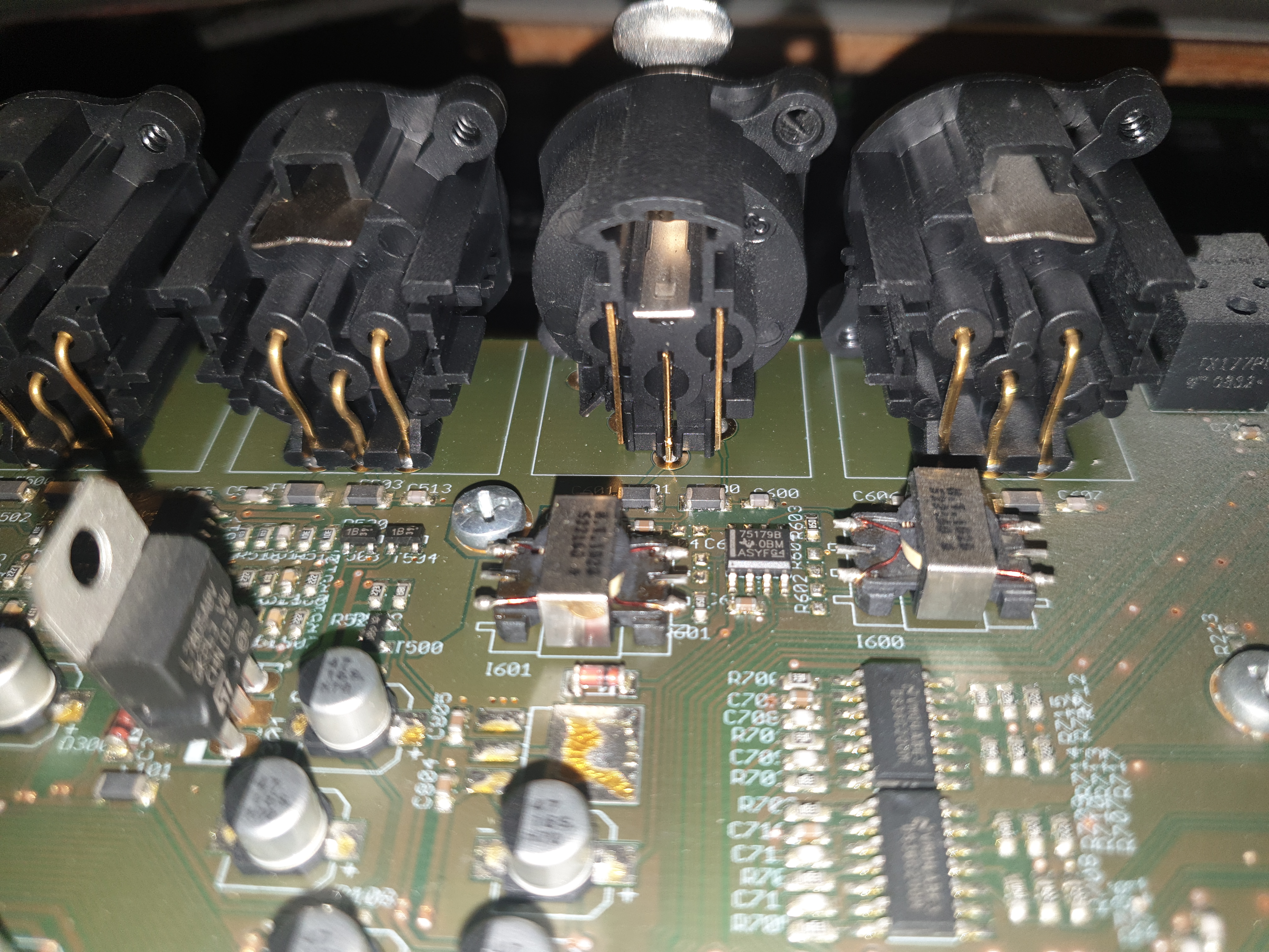

Well I've opened her up. Can't see anything obvious, but I'm only looking on the top board. It's a bit of a faff to look underneath tbh. Also getting the lid back on is proving more difficult than I thought it would.
14 XLR Outputs Right.jpg (4.6 MiB) Viewed 19597 times
13 XLR Outputs Left.jpg (4.42 MiB) Viewed 19597 times
