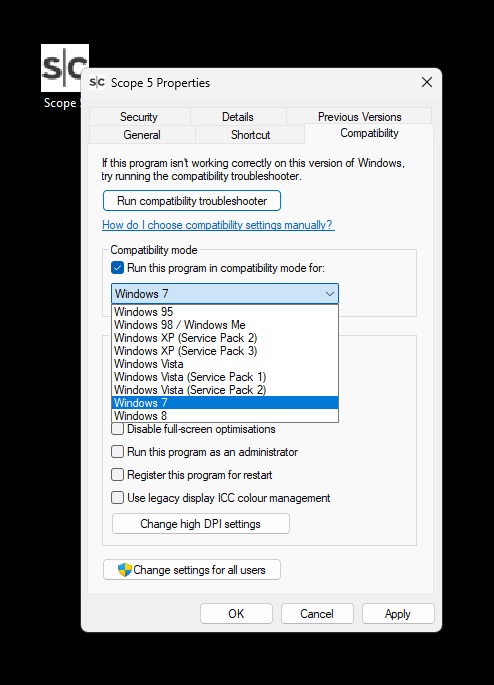

try running Audition in win8 compatibility mode.

garyb wrote: Fri Aug 04, 2023 6:15 am try running Audition in win8 compatibility mode.
Was just thinking the same thing.
Like I did on one of mine computers, Win11, after Cubase Elements update, from 9.5 to 12, SCOPE (5.1)/ASIO was not recognized anymore, so I tried with "compatibility" mode and now works fine on that machine.
On machine with win10, Scope 7 didn't have any problems so far with updated programs. (Sound Forge, Cubase ... ).

And how can I running Audition in win8 compatbility mode? -Matti

On Shortcut right click - properties - compabitility mode.

Hi, I dont find the shortcut to SCOPE 5 properties?
-MATTI

When I install Scope software, shotcut is always automatically created.
You can always create your own shortcut for any program you want to.
Right click on desktop and select create shortcut, then browse to Scope folder, where Scope.exe is located.

not Scope 5, but audition....
you have Scope 7, right? Scope 5 in the picture was just an example.

garyb wrote: Thu Sep 07, 2023 6:23 am not Scope 5, but audition....
yea, you are right, scope 5 was just example, on Audition's shortcut 👍🙂
