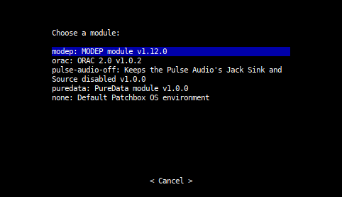

Once that's done, there's a simple startup script that can be called again at any time from command line ("patchbox") to configure things, and install "Patchbox Modules":
Screenshot 2023-03-04 191954.png (12.48 KiB) Viewed 3221 times
As you can see, the Modep emulation environment is only one of several available 'Patchbox OS Modules' that are available for installation. I have other means of running PD, but have noted that the ORAC module might be of future interest (it's a modular environment).
