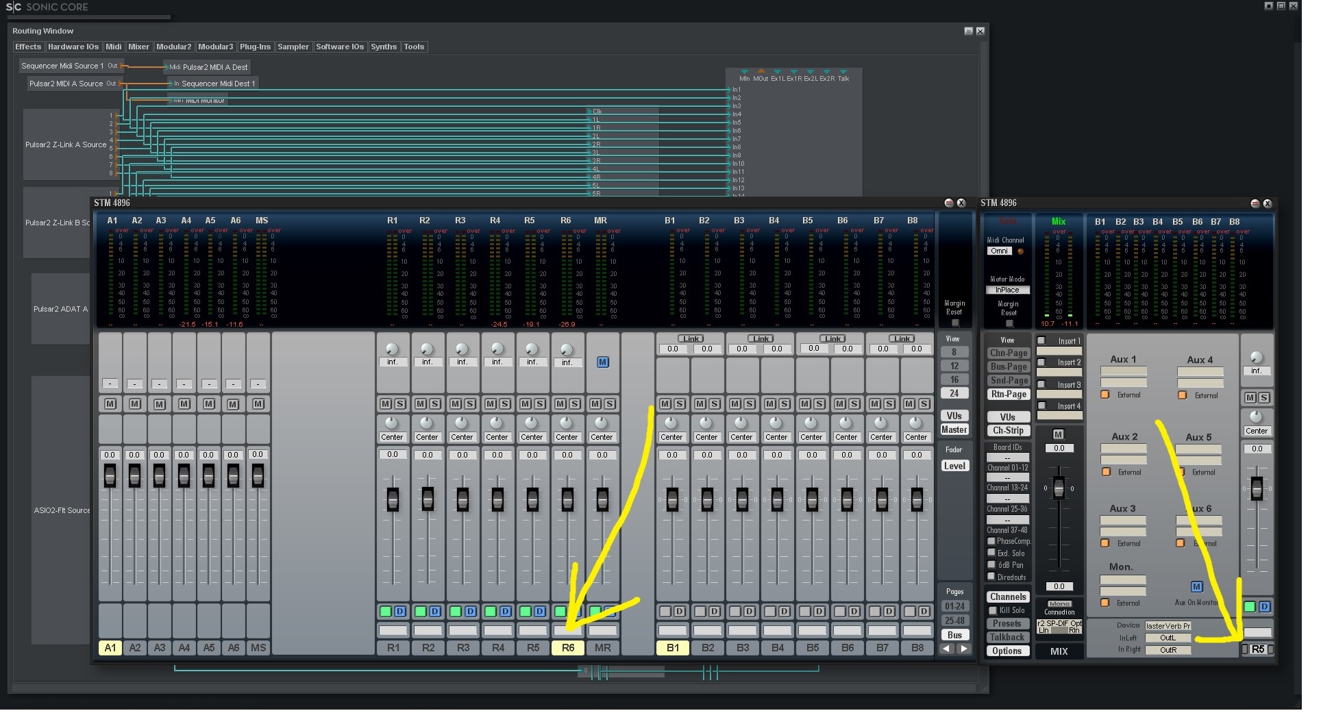

Silly bug, in 2448 and 4896 mixer on Rtn-Page, the Return 6 have wrong name, it's R5 instead R6
See attachment picture
Another thing about send/return (not a bug), 4896 mixer start as default with all (R1,R2,R3,R4,R5,R6,MR) Mix and Defeat "disabled", 2448 start as default with all (R1,R2,R3,R4,R5,R6,MR) Mix and Defeat "enable". This take me a little bit of time to understand why send/return not work on 4896 at the beginning.

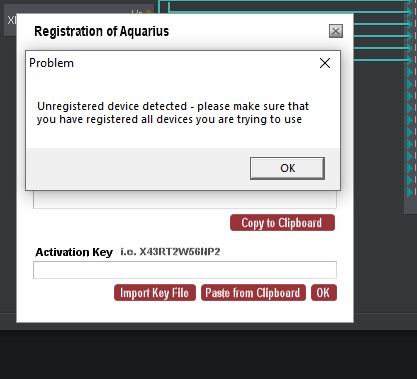

Don't know if this was already reported (seems to be a very old bug - see here for example: viewtopic.php?p=298721#p298721).
When you want to register a new device and don't have the key yet, you're stuck in a loop and have to force quit SCOPE, because the registration window keeps coming back again and again.
