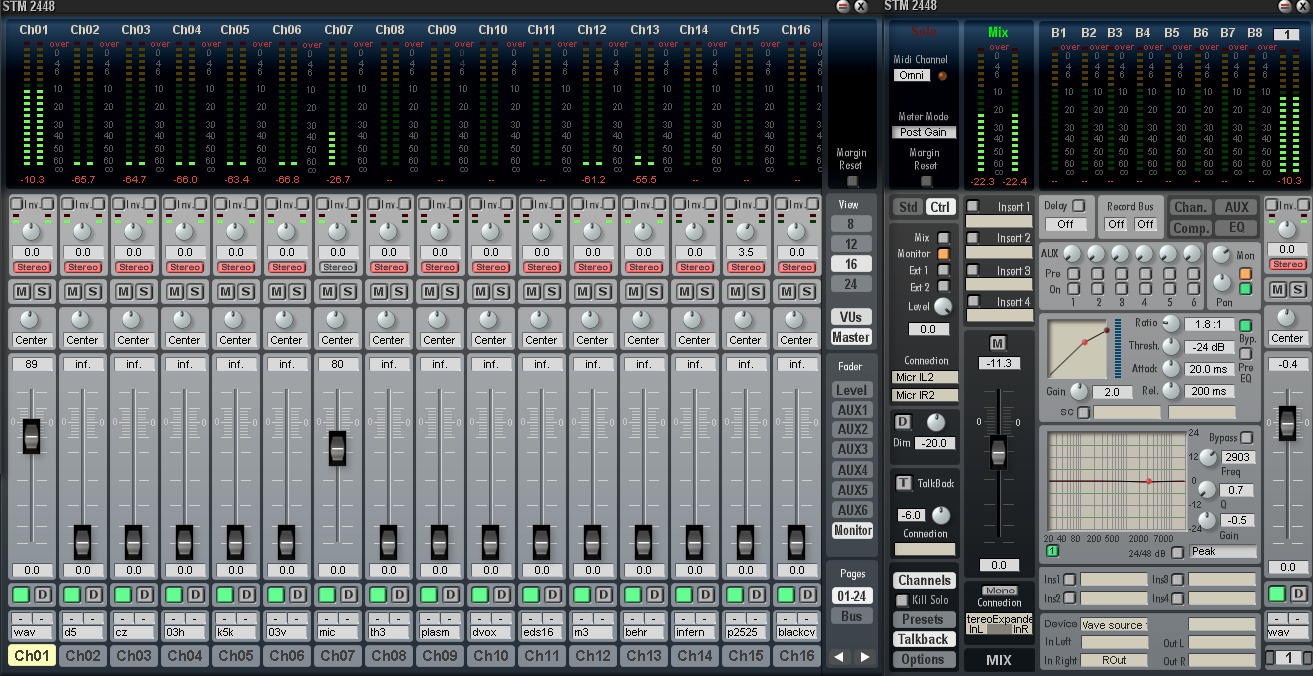

I'm facing a simple problem, which I cannot solve for 2 hours now:
I try to get Ch01 on CTRL-Output.
Setting to mix gives full output, but setting to monitor give just silence.
What is missing ?
What is missing ?
- Clipboard02.jpg (319.33 KiB) Viewed 6094 times
Re: no sound on monitor
Show your project please
Yes, are you sure you have the correct outputs selected from the mixer module on the routing window to your monitors?
nebelfuerst shows Ch1-16 now. On the Bus page (lower righthand corner there), I'd check the monitor channel strip.

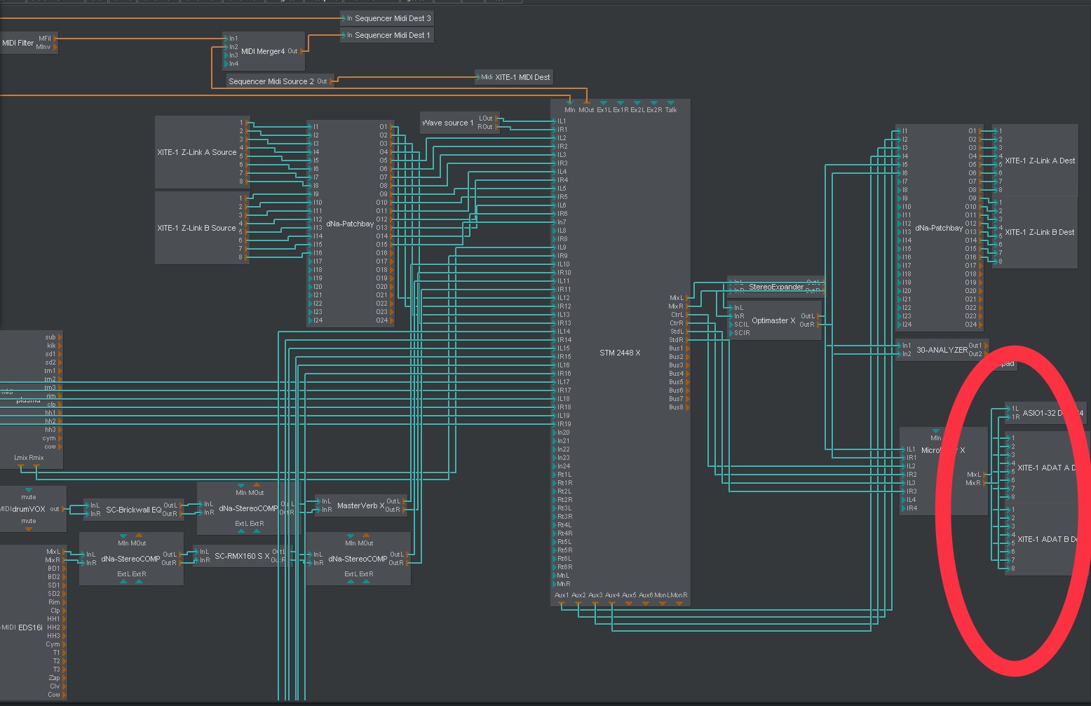

Here are some more pics.
I use VU-meters of micromixer to check for output signals.
Selecting "mix" gives signal, but selecting monitor just silence.
- Clipboard02.jpg (248.91 KiB) Viewed 6049 times
- Clipboard01.jpg (208.75 KiB) Viewed 6049 times

From the 2nd pic - mon L and mon R are not connected on the stm2448 (bottom right on stm2448 in routing window)

I attached micromixer to monitor, and now everything works.
Ctr and Std never gave a signal and now I can control them, just like I expected.
It doesn't seem logic to me, maybe it's a miracle in christmas time
Here's a screenshot of the setup, when Ctr and Std delivered signals...
Thank you again, for your help.
- Clipboard01.jpg (421.44 KiB) Viewed 6034 times

I'm guilty of abusing ctr to extract one channel out of 2448 to an external PC.
Therefore I did't have any need to connect anything to mon.
It works like Spielraum explained. It seems to be a DSP saving mechanism connected to MON, which affects CTR and STD, too.
On first screenshot, there is nothing comming out of STD and CTR.
On the second screenshot, I connected one Mon to a device.
Now STD and CTR immediately deliver stereo output.
- Clipboard01.jpg (38.38 KiB) Viewed 5935 times
- Clipboard02.jpg (37.93 KiB) Viewed 5935 times
