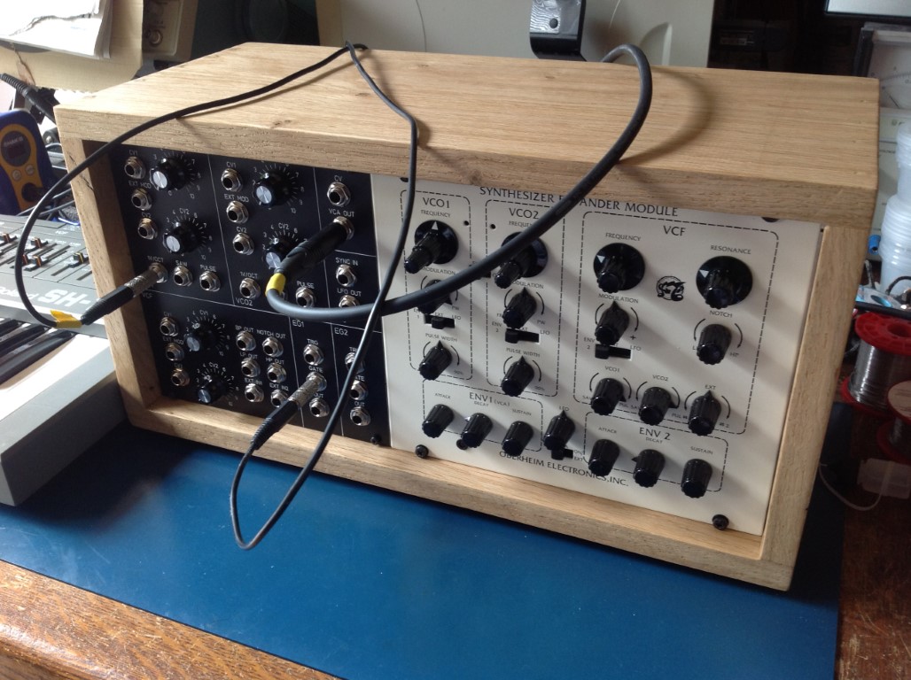

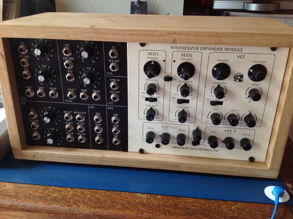

I finally finished my Oberheim SEM project. It took some time due to a few delays and some small issues that needed resolving. But all in all it went quite well, and its now working well and sounds fantastic. Anyway, thought some of you might like to see the end result.
12 A clearer view (Medium).JPG (218.32 KiB) Viewed 3926 times

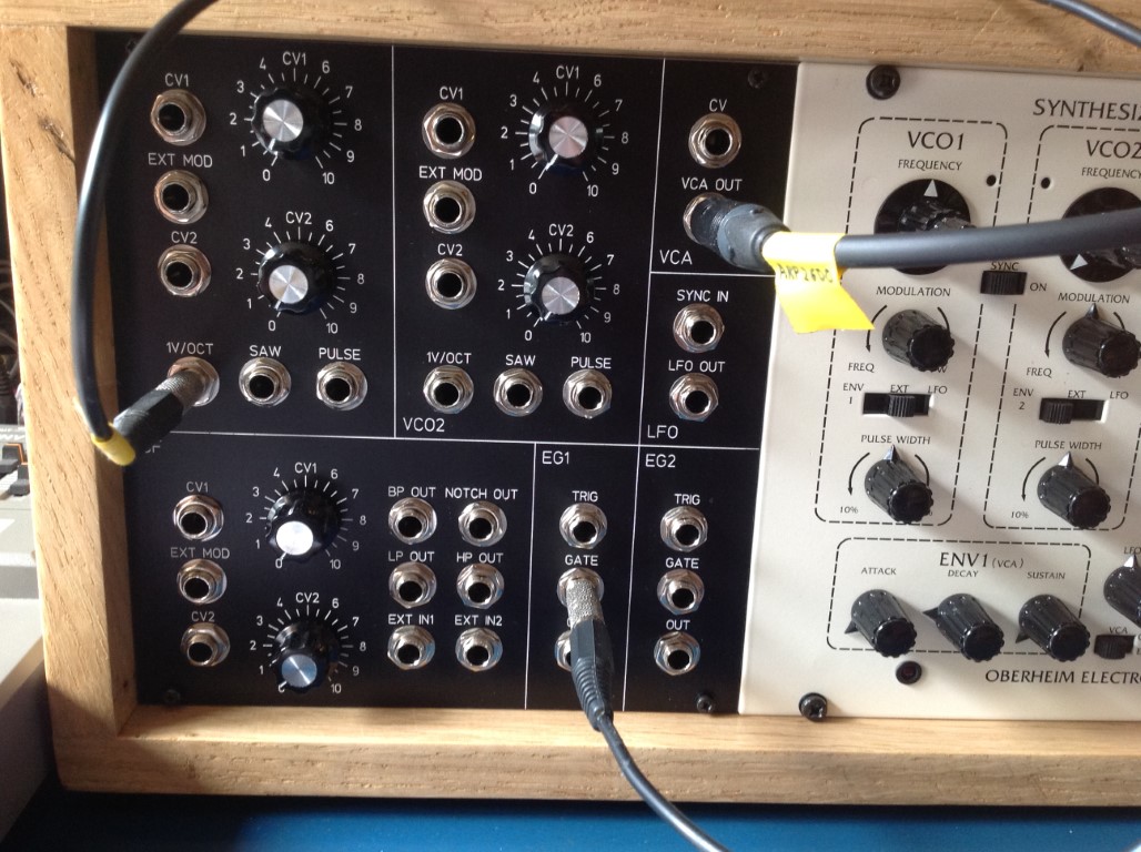

11a Unit connected and working (Medium).JPG (207.6 KiB) Viewed 3926 times
11b Unit connected and working (Medium).JPG (220.18 KiB) Viewed 3926 times
11c Unit connected and working (Medium).JPG (201.74 KiB) Viewed 3926 times
10e Back Panel fitted & connected to a Yamaha PA-10 linelump (Medium).JPG (146.91 KiB) Viewed 3926 times

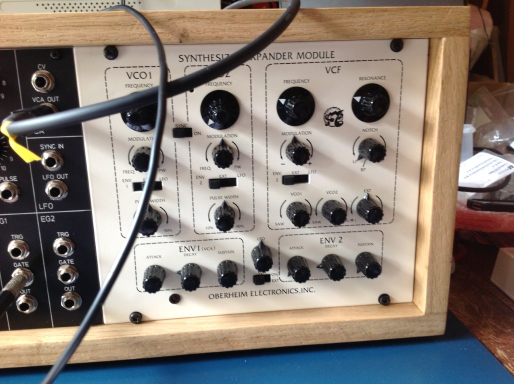

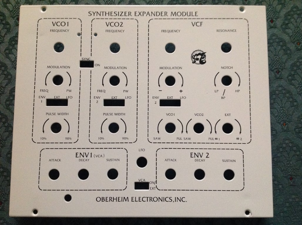

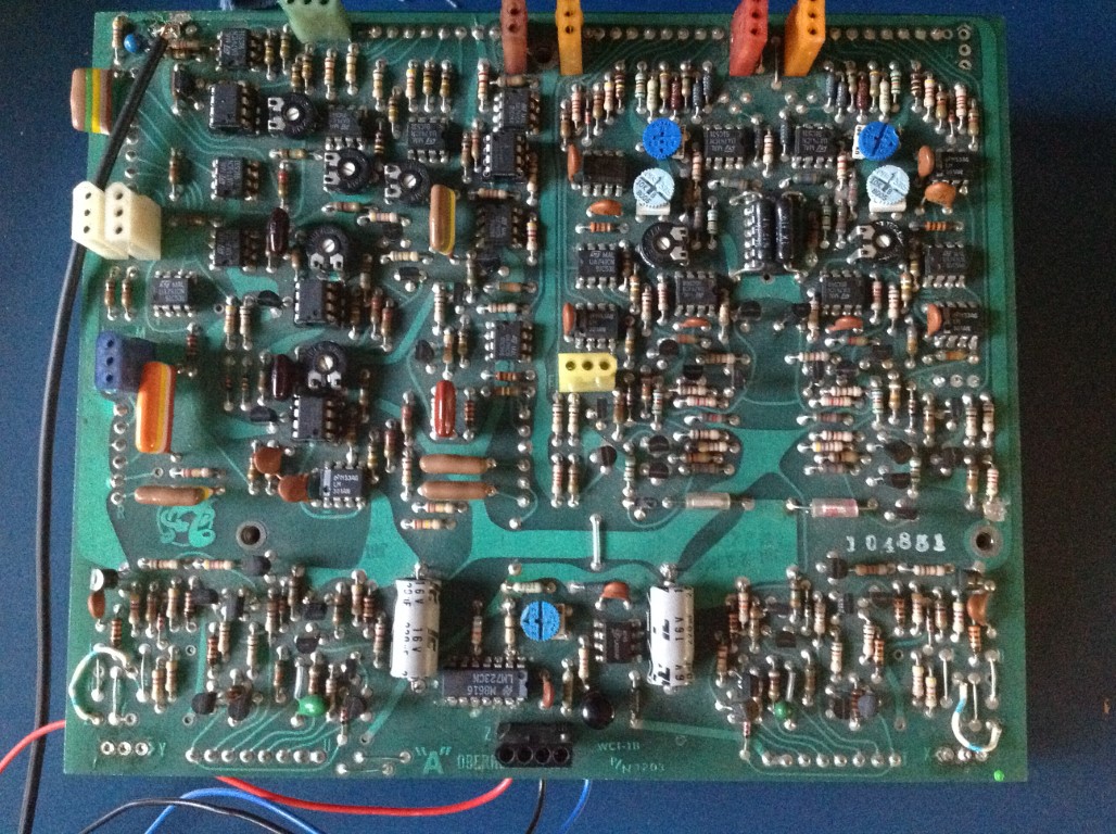

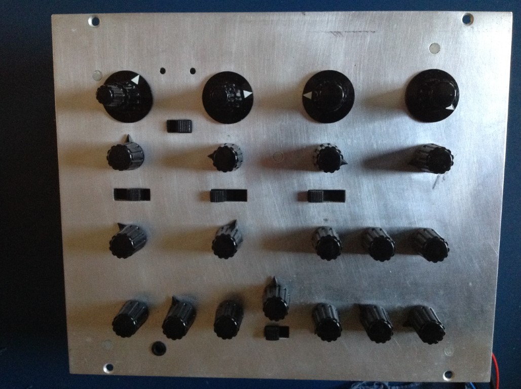

The SEM panel when I first bought it, and after getting it silk screened
1a SEM Front panel- As it came from seller (Medium).JPG (188.06 KiB) Viewed 3925 times
1b SEM PCB - As it came from seller (Medium).JPG (313.76 KiB) Viewed 3925 times
4 SEM panel after Silk Screen (Medium).JPG (222.91 KiB) Viewed 3925 times
5 IO Panel before wiring (Medium).JPG (143.03 KiB) Viewed 3925 times

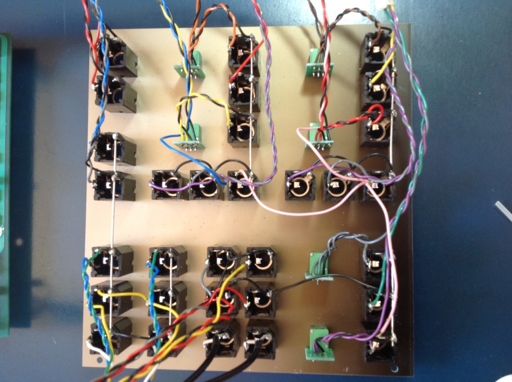

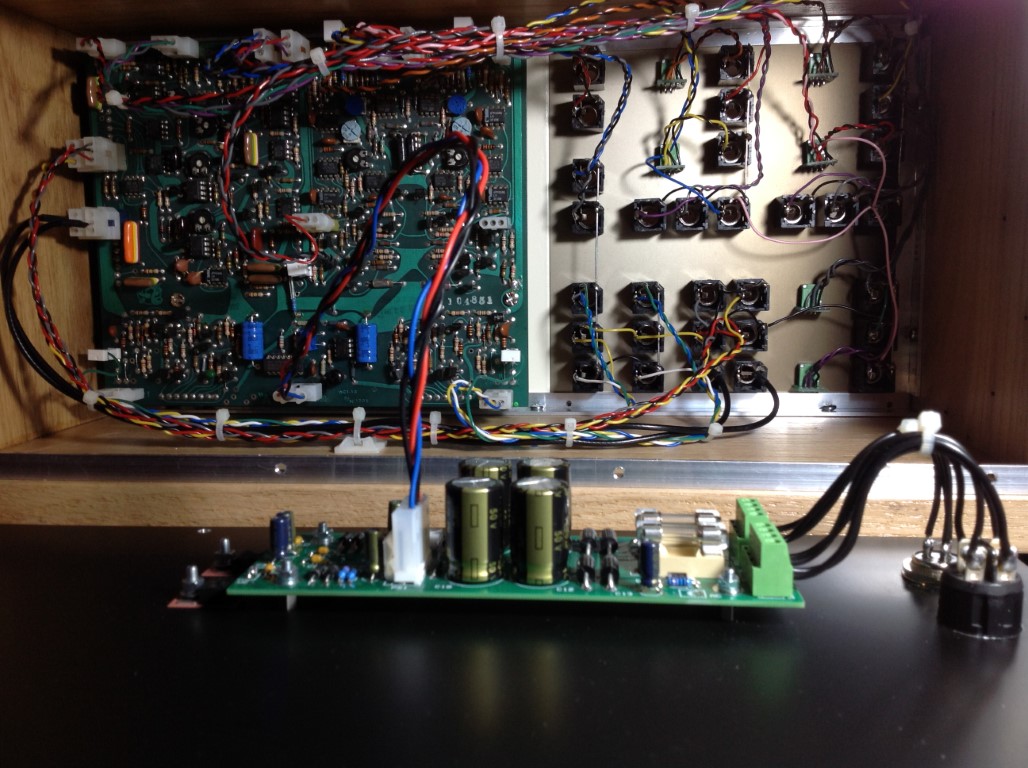

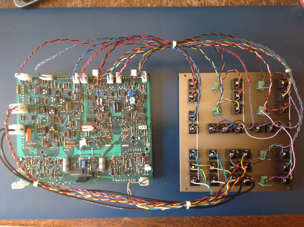

Wiring it up
6a IO Panel after wiring - before swapping the 2 purple wires on bottom right VCF CV2 pot which are incorrectly placed in this photo (Medium).JPG
6a IO Panel after wiring - before swapping the 2 purple wires on bottom right VCF CV2 pot which are incorrectly placed in this photo (Medium).JPG (185.4 KiB) Viewed 3923 times
6b SEM & IO Panel after wiring - before swapping the 2 purple wires on bottom right VCF CV2 pot which are incorrectly placed in this photo (Medium).JPG
6b SEM & IO Panel after wiring - before swapping the 2 purple wires on bottom right VCF CV2 pot which are incorrectly placed in this photo (Medium).JPG (235.16 KiB) Viewed 3923 times

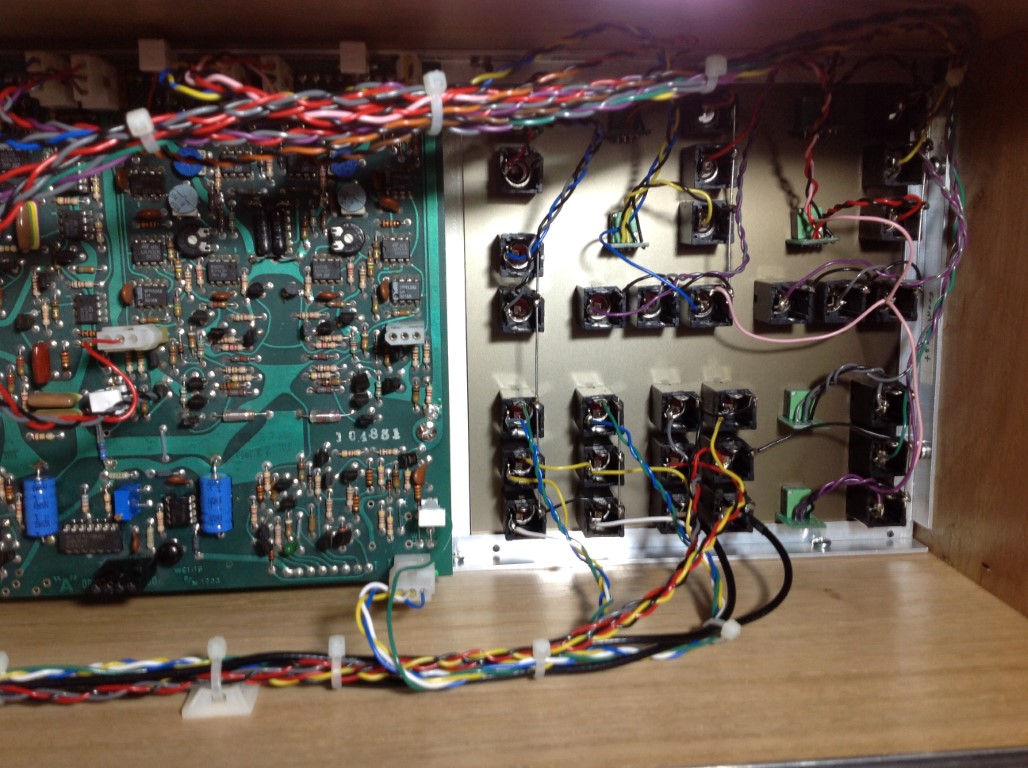

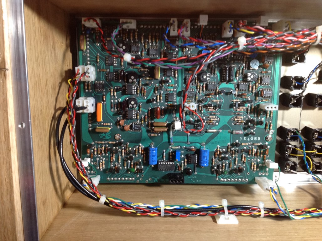

10a SEM panel installed & connected (replaced 220uF axial caps, transistor & regulators) (Medium).JPG
10a SEM panel installed & connected (replaced 220uF axial caps, transistor & regulators) (Medium).JPG (255.72 KiB) Viewed 3923 times
10b IO panel installed & connected (need cable tie holder for top cables) (Medium).JPG
10b IO panel installed & connected (need cable tie holder for top cables) (Medium).JPG (217.4 KiB) Viewed 3923 times
10d SEM & IO Panels fitted with back panel open (Medium).JPG (222.19 KiB) Viewed 3923 times
Posts: 8467
Re: My completed Oberheim SEM project
nice one - and congrats for the job 8)
Incredible sound too I bet.
Is it 2 voice or monophonic?
Thanks T.
t_tangent
Posts: 989
Post by t_tangent »
thanks astroman and dawman.
No it has 2 VCO's but it's only monophonic, the black panel is just for Ins & Outs. I read that Tom Oberneim said a 2 voice was his preferred number of SEMs, and it would be nice to add 1 more to this...although I woudn't mind a 4 voice. :) I remember seeing an 8 voice once and they sound incredible, but they are massive.
very nice, i like it.
the phone jacks could be upgraded would be my only criticism. rhat said, i'm impressed. the audio business was once made of products like this. ask Bob.
Posts: 2942
cool, great work !
Especially your patch panel looks amazing !
But ehhhmmmm,- now you need 7 more !
:D
Posts: 7786
I'm all in for 7 more as well. Nice work, it feels great to make things by hand.
spacef
Posts: 3364
Post by spacef »
looks very clean. congrats !
i would have done the back as a door that can be opened easily (like...a door, lol) rather than screws, but i suppose you don't go in there often to change jumpers or add modules...
That's what I have done on my modular and it is really cool not to have to unscrew everything (but it is not complete as is yours, so i still need easy access).
congrats again
plug-ins for scope
SpaceF website
SC website
t_tangent
Posts: 989
Post by t_tangent »
Thanks for the kind words everyone, and I appreciate the advice for improvements as well.
Gary, you are right I should have used better quality phone jacks such as the Switchcraft 112APCX sockets. At the time I was getting parts together I didnt know how it would all turn out and the wiring looked quite daunting at first so I was trying to keep costs down. I recall the price difference between these sockets and the Switchcraft was around £50. I probably will put Switchcraft sockets in at some point especially if these start playing up although they seem to be ok so far....we'll see. :)
Spacef, yes I did think about making the back panel open on a hinge like a door, but I think in the end I was in too much of a hurry to finish it. :) I remember you posted up some photos of your modular a short while ago so I'll have another look at how you did that. I don't really need access to the inside of this unit except for calibration or repairs but if that changes I may try to work out how to add a hinge. :)
Anyways, thanks again all, and yes, now to look out for 7 more, LOL.

Thanks
No, the first time I tuned it on it didn’t work at all, but luckily I found out quite quickly that it was only a transistor that had blown and had taken down the negative rail, probably due to one of the caps failing. But it was an easy fix, just replaced those parts and for good measure the other cap since they were over 40 years old.
second time on it worked fine :)
