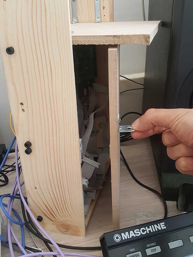

ah I found the pics of the making of my rack
There is a back door which is really cool because you don't need to remove any module to access the power plugs. an innovation by SpaceF
(I haven't seen anything like that on commercial racks or cases).
On mine, I can have modules of 8 cm depth max (or they touch door, and I would need to change for deeper side-panels)
- 20200715_114035.jpg (51.51 KiB) Viewed 29388 times
- 20200701_003207.jpg (56.77 KiB) Viewed 29388 times
- 20200630_234932.jpg (93.53 KiB) Viewed 29388 times
- 20200630_221807.jpg (50.77 KiB) Viewed 29388 times
- Holes were moved to put the modules "deeper". here it is 2 or 3 cm from the edge
- 20200630_221729.jpg (92.85 KiB) Viewed 29388 times

Here is a pic with the next updates, at least those visible on the surface.
I am taking the time to check everything in my "global project" so it should be available within a week.
1 - Manual/LG: this is an interconnection with another device "LogiQ" (forthcoming modulator in the "Aquarius" drum box (another product) - LogiQ can be master of the tempo and gate restarts of KrOn, ensuring they are both always in sync. LogiQ can resync every 4/6/8 measures (8 measures = similar to 128 steps).
The "manual" Press button can be mixed with the LG input from LogiQ. However, if you have LogiQ, you would sync all devices from LogiQ gate menus (using LogiQ own "press" button which also regates the regaters
)... unless you are looking to desync your sequences, which can help finding new inspiration more or less randomly.
I am also working on astandalone device to sync all project devices (KrOn and other spacef stuff), which will be done only once the rest is released (and it will require updates to include the adequate "receivers" inside those devices. For KrOn, it will include a "main gate" and a gate for the quad. I intend to add a CV sync for CV gear (you can do it already but that will just be a dedicated output).
When Kron is "slave", incoming notes-on do not trigger the sequencer (which is not new as we had the "manual mode", but the interest here is that you do not need a midi cc to sync KrOn, ie you can work in Scope and fire the sequencer once you need to record something - and at this point you will go from LogiQ sync to notes-on or manual CC.
2 - Color presets, more uselful than it looks, allow to load your setup of text/colors.
2b 2c - You can also adjust some modulators internal gains (mostly unpitched modulators like LFOs), and you can set the Bias cap values too (advised 0 or +3 dB). The bias control is just too valuable with eurorack modules that do not have an offset (like some VCAs) and that's why I added #7 below (to use bias in last slots while still having 2 modulators).
3 - new leds for the 32 steps. 2 rows that show the 32 or 16 step state of each line. Makes things immediately better. 16 steps is generally used to use CV and DSP tuning on the same line of 32 steps. Now it can also be used to simply visualize 32 and 16 steps animations at the same time. This feature already exists in Mini KrOn and was too good to be left out of Big KrOn.
4 - Time-synced ADR on both EG
5 - LFo3 rate modulation, and LFO 1/2/3 can derive a note-on/off from the T LFOs. This allows to have fade in/out even without incoming notes on/off. It allows to create "crossfading" between LFOs and boosts KrOn's modulations by a great number. Allows making rythms not available previously.
6 - useful leds on EG and LFO rate modulation.
7 - 3rd input selector on outputs A3/A4
8 - Color selectors on front panel. The colors themselves are not selectable anymore, so there is no more acidental changes of colors while editing the mixer outputs. Now you can use the small white knob in the bottom right corner of each output section.
9 - added LFO T3
10. Ext 1 / Ext 2 do not go through a dsp to cv attenuator, but directly to the mixers, so you can use pitch/modulators from other devices, wether CV or DSP, and it will remain untouched.
11. LFO 1 / 2 / 3 as EG triggers
12. Correction of the manual tempo on T1/T2
I think that's all folks...
