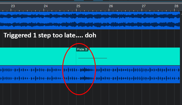

- At the end, I Still got the melody wrong by 1 step but who cares
(the notes are right but mistake pictured below, explaining why the last step in on the kick...
- DoH !!! :-)
