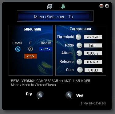

https://spacef-devices.com/DOWNLOADS/Mo ... orBETA.zip
Enjoy !
It works well with scope modulators too (lfo, sequencers etc).

Thanks to user feedback , a small bug was found in the current beta, that may make you think it actually does not nothing... but it does.
- You need to select another value than the current one in the Boost Gain menu selector. This will reset it and let sidechain pass through. This will be corrected in the next version.
In mod Mixer v2, modulation is available on inserts 2 and 3 of channel modules.
- Put the "F" pot to a value between 5-10% and 1/3rd, and the gain value at max.
- Adjust the F pot to you liking. if F is too low, the modulation is not heard, and if F is too high, the modulation can be out of range or not heard (it is compressed to the max with 0 dynamics). The F is like a sidechain gain, but it can also change the response curve of the compression.
A modulation or audio source should be connected to the Channel Modules inputs A/B/C/D.
If you want to compress a signal by itself, please choose one the stereo modes for the moment... In a mono channel, the Right channel will be ignored, unless you choose an effect routing that outputs on 2 channels. A mono-Self mode will be added in next version.
Thanks a lot for the useful reports !

I've just put a new version. I hope it works fine this time.
"How to" video : https://youtu.be/BiDPmjHhKTw
The drum track is connected to modulator A of the mixer.
Then, playing with Threshold, attack and release change the way the sound responds to the sidechain signal.
About the F, when I said "put it at 5-30%, it is valid with +12 dB gain. With loxer gain, the F must be higher then 50%.
also, i noticed a mistake in M4 module. The Reverse signals are the 4 last. The A/B/C/D modullations are the 4 first entries (of the menu). I will need to correct this (on all modules??) :-/
