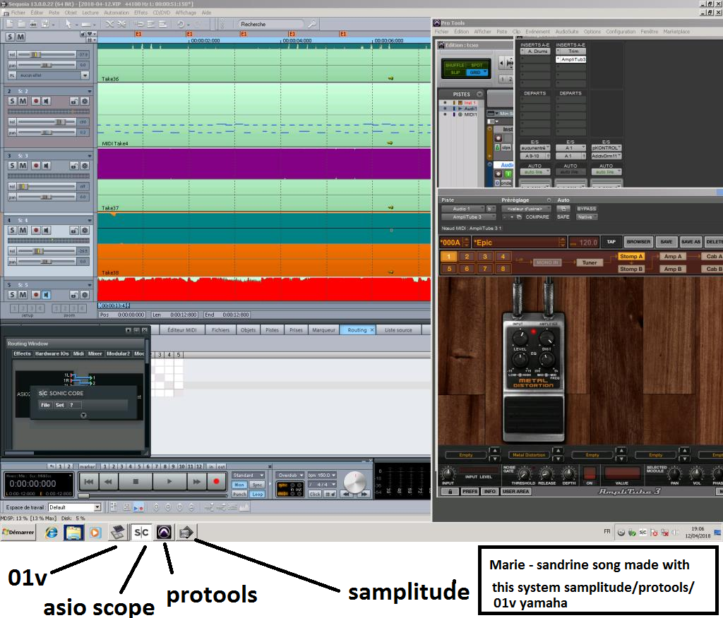

hi i make like you working scope 5 with protools hd so powerfull no more latency real time playing recording with RTAS plugins at 64 samples !
- protools hd salved by samplitude.png (755.33 KiB) Viewed 10453 times
