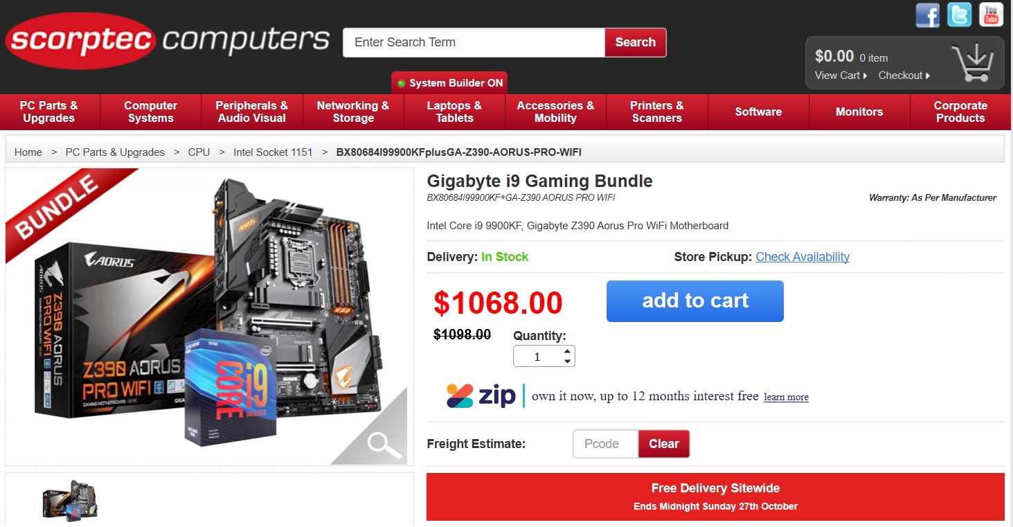

So the below system should work with XITE-1D ?Sounddesigner wrote: Wed Jan 23, 2019 8:26 pmThat i9 9900K 8-core processor is probably the most powerfullest so far now that is confirmed to work with SCOPE XITE-1. Looks like a super beastly system you have there. Thanks for posting your specs here, such info just may be some seriouse help to someone else looking for a true powerhouse system!Pygmy Audio Farms wrote: Sun Jan 20, 2019 4:15 am motherboard: Gigabyte aorus z390 master
chipset: Z390
processor: i9 9900k
RAM: 32gb
Graphics card: nvidia passive dual monitor
OS: Windows 10 64-bit
ssd, liquid cool cpu etc makes a silent pc
Does it work? (i.e., GREAT!, NOT AT ALL!, Occasional Glitches, Frequent Glitches): Great, silent
XITE-only or XITE+ScopePCI (please list): XITE-1
https://www.scorptec.com.au/bundle/CPU/ ... S-PRO-WIFI

dante wrote: Sat Oct 26, 2019 4:01 pmSo the below system should work with XITE-1D ?Sounddesigner wrote: Wed Jan 23, 2019 8:26 pmThat i9 9900K 8-core processor is probably the most powerfullest so far now that is confirmed to work with SCOPE XITE-1. Looks like a super beastly system you have there. Thanks for posting your specs here, such info just may be some seriouse help to someone else looking for a true powerhouse system!Pygmy Audio Farms wrote: Sun Jan 20, 2019 4:15 am motherboard: Gigabyte aorus z390 master
chipset: Z390
processor: i9 9900k
RAM: 32gb
It should work, i don't see why it would'nt. I'm judging by Pygmy Audio Farms's specs in his post so i can't say with 100% certainty it will work. All we can do is look at someone else's working specs and copy them as much as possible and thats often the safe way. v7 of SCOPE eliminated a lot of issues with latest computers and SCOPE so more compatibility success stories have been posted and it's less risky now.
Let us know how it goes with that Weapon-Of-Mass-Destruction DoomsDay Device

Yup, should do as it's the same stuff on that board. Had no problems. Working out what bios settings to turn off is a conundrum which still has me scratching my head, though nothing I've disabled so far has compromised performance. The Xite card sits nicely in the top x1 slot next to the processor, after much reading I reasoned this slot isn't throttled/shared with an m2 ssddante wrote: Sat Oct 26, 2019 4:01 pm

Can confirm the following works with XITE-1D :
Motherboard: Gigabyte Aorus Z390 wifi pro
Chipset: Z390
Processor: i9 9900
RAM: 32gb
O/S : Win10 x64
Sample Rate: 96Khz
SSD: 1 x 500MB for O/S and Apps and another 2 x 500MB M2 SSD for projects, stems, samples, refills, Kontakt libraries etc. Plus 2 x 1GB External SSD on USB 3.1 for archival / backup.
I did have to install Scope 7 over an older Scope 5 install to get rid of a startup warning regards timeout on DSP6 (which doesn't occur on Win8). However that was also true of installing Scope 7 on my previous i7 4790 system.
Other than that, everything works. Of course no PCI slots on the Z390 so I left the cards in the old system to use at 44Khz with Spewbase. Scope XITE-1D co-exists with UAD2 OctoCore on same system.
Gotta say the M.2 SSD f*****g FLY man. These are what make the system really hum. And the Mixbus32C native DSP load has dropped from about 90% to 30%, as it now has 8 x FPU to run on (MixBus32C uses FPU so hyperthreading is no benefit).
I would say if you're looking for a new motherboard, M.2 is an instabuy and only got recommended it by luck showing the mobo spec to the I.T. tech here at work. Before that I was unaware of its existance & implications for future larger orchestral streaming libraries/loads etc.
