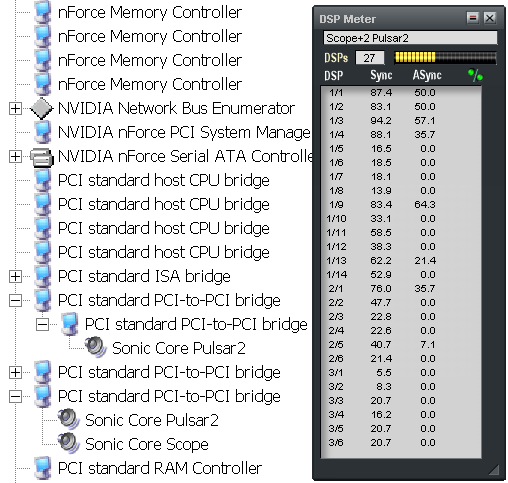

sad news: It is not working on my system!!!!
the driver installed but with two cards on the PCI extender i got a communication error with a DSP of a board and some more errors.
so SFP is not loading at all.
i have tried to install just one card (scope 15 dsp) removing the pulsar (6 DSP): SFP is starting but i see no improvement at all in PCI performances. I can load 9 masterverb either with the PCI extender or in the standard configuration.
so i'll simply give up... :(
maybe is my gigabyte board.
i also tried two different PCIe slots but in one of them the system is not starting at all.
if someone wants to try i can give him the board for something less than what i paid it...

my idea is that you can use the PCI extender to add a single card to your system but can not rely on it to use 2 cards or to increase the PCI bandwidth performance. in fact i had the same masterverb count with or without the PCI extender (using only the scope board)
in my case i could probably add a third card but i don't really need it...

et voila:
For now, I've added this 6DSP XTC-card with no IO, and I've only loosely hung it inside the PC case. No MV testing, just loaded yesterday's project.
The ultimate test ofc would be to move all 3 DSP cards to those expansion cards (I have 2), for those motherboards who don't even have PCI slots. But I don't have a need for that nor a proper machine for that now, and also..
The ADAT connectors on my other cards (Scope, Pulsar2) aren't too convenient to remove and insert (quite some force is required for that, damn metal connectors on the cables), so this is ok for me - for now. Later I may go look for an extra IO board, but I'll have to jump that bridge when I cross it ;p
edit: the PCIe to PCI adapter card, €12.5 at time of writing: https://www.aliexpress.com/item/32849431927.html and the extension cable: https://www.aliexpress.com/item/32857626033.html
more has been done with less
