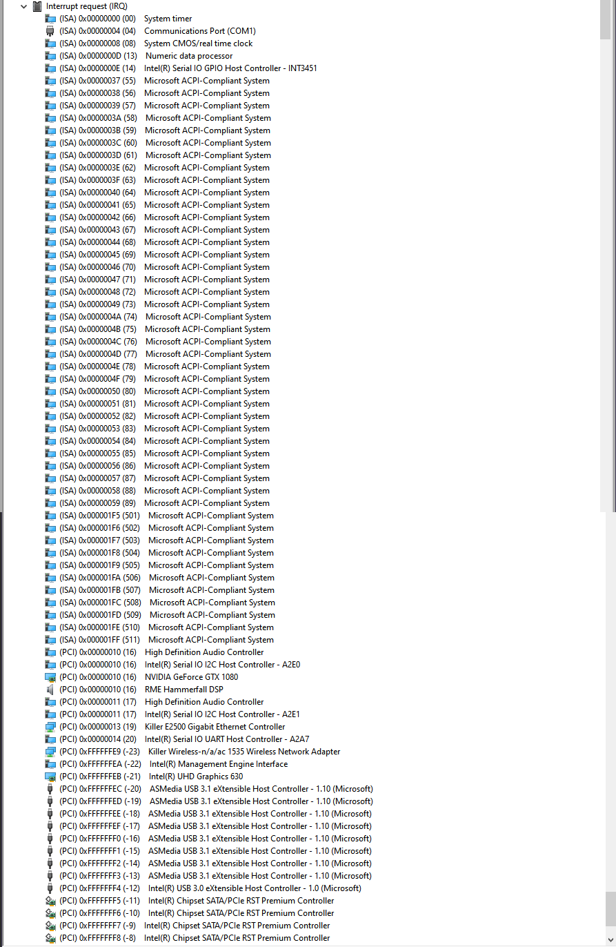

valis wrote: Thu Aug 01, 2019 2:57 pm IRQ sharing won't show up the way it used to, as you have to disable ACPI (in BIOS, and set the Windows HAL to MPS Multiprocessor rather than ACPI Multiprocessor) to be able to see shared IRQs that way.
maybe I mistake your comment,- but when going into device manager > view > ressources by type > IRQ (interupt) request ...
IRQ sharing should be shown w/o changing anything in BIOS,- no ?
I hope I described that right because I´m on a german OS,- thats´s why I explained for Marco in german in former post and just only for the case he might need such explanation at all.
IRQ sharing will NOT be shown on a modern system with BIOS and Windows OS all set to defaults, because ACPI stacks everything on on a few IRQ's (for the most part) and remaps everything from there in the relatively 'virtual' ACPI irq-space.
Case in point, notice in my screenshot here that there are 512 (virtualized) "ISA" IRQ's, and everything "PCI" (which includes PCIe) is largely on IRC 16-20 (below #511):

I cropped that image between 89 & 501 obviously, to save space. In my case, you can see that there are 3 devices sharing IRQ 16. On a Core2 era machine and before, I might try to switch the computer type (at the top of device manager when you do view>devices by type) to MPS x64 Multiprocessor PC and see if I could resolve IRQ sharing, but I haven't had to do that in 8 years to a system. (I might also give a reminder however, that I also still run Scope in an older system as a sidecar machine as well).

valis wrote: Thu Aug 01, 2019 10:33 pm
IRQ sharing will NOT be the same as it was for Scope's original era---on a modern system with BIOS and Windows OS all set to defaults ACPI stacks everything on on a few IRQ's (for the most part) depending on what bus the hardware uses, and remaps everything on those shared IRQ's as it sees fit (well beyond what Plug & Play used to do).
Yep, I´ve recognized that to on my office machine running Win7 SP1 32Bit.
These "ISA" IRQs were never seen in WinXP ...
Nonetheless, I see your HD Audio Controller, Intel serial I/O 12C Host Controller-A2E0, NVIDIA GTX 2080 graphics card and the RME card share IRQ #16.
So, when I´d use XITE-1 instead of RME, I´d at least try to find a better slot to get out of the way from graphics card and disable HD Audio in BIOS or deactivate in device manager.
It might not urgently necessary w/ your RME card though.
I dunno what the Intel serial host controller does, so no idea if it made sense disabling/de-activate that too.
To me that means, that list is indicator for IRQ sharing still, but much more complex than before and better than nothing.

Bud Weiser wrote: Fri Aug 02, 2019 7:26 am
Sometimes and w/ luck, the audio card won´t show IRQ sharing or disabling some USB does the trick.
On my office machine mentioned above, the HD Audio Controller is on IRQ #22 exclusively,- so that is what I use w/ ASIO4ALL and earphones,- just only for testing plugins after download in different hosts like Reaper, Tone2 Nano Host 1.0.2 and Cantabile lite,- and it works w/ 256 samples buffer size.
Even I already disabled some stuff like Firewire and LTP in device manager, this machine allows some more optimization since I recognized some driver ("USB to USB2 something" shown by LatencyMon) kicks in occasionally and after a longer period of time.
I cannot identify this driver though ... it seems to have a different name on the machine or isn´t shown in device manager or such.
It´s Gigabyte 956P-DQ6, socket 775 w/ Intel Core2Quad,- so it might be good for SCOPE PCI.
While it is using an interrupt, the main takeaway is that the GPIO controller device allows modern hardware to talk to legacy ports & devices (on a motherboard, typically) that are much more fixed in addressing than the PCI & PCIe devices are.
As for IRQ sharing I agree somewhat, however let me clarify that in a moment in a separate post, as it may help others over time beyond this discussion thread alone. The main point however is that a shared IRQ on a modern system (anything past Core2 for certain) doesn't mean what it did when our Scope cards debuted. While they haven't changed in their PCI bus implementation, the way that bus is addressed and mapped to IRQs has changed vastly, and this means many devices can 'share an irq' with no issue, even with Scope, imho. That's because the controller chips that are talking to them virtualize the whole address range and interrupt stack anyway, so what 'looks' like IRQ 16 for the same devices is not that at all when looking at the addressing on a lower level per device. It's literally just an address exposed when the 'what IRQs are in use' query is made from the software side.
I'll break that down in that other post, so let's branch the IRQ related specifics off this off to this thread: IRQ sharing, the PCI bus, ACPI/APIC addressing and your Scope cards
