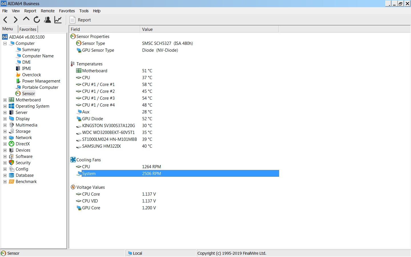

Thanks guys for the valuable advice.
Installed while 2 Pulsar2, 2 hdd, normal flight.
drive a couple days... realy it maybe need to do pc prevention
Re: HP xw4600 very hot
3 cards 1 stdm connector - work great
replaced battery
set the side panel
room temperature 25° C, when less than 20-22 pc is not heard at all
the system fan works quietly until 2000 rpm, but after - starting to make noise, especially closer 3000 rpm.
What is better, replace system fun or install an additional front one? or wait for winter? ))
Does any 92 mm 4-wire high frequency PWM 12v fan is sutable?
							replaced battery
set the side panel
Depends on the noise, but push/pull is much better than just push (pull air in, push air out).  Once you get that far and keep noise at a manageable level, people tend to get into discussions of positive vs. negative pressure (do you want to PUSH more air IN=POSITIVE, or SUCK more air OUT=NEGATIVE).  Positive pressure, in theory, pushes dust out of every crack, whereas negative pulls it in.
Most server configurations, conversely, are LOUD and entirely negative pressure (massive arrays of small fans pulling through the 1U cases, which is why those configurations can use passive coolers on all internal components). From that you can tell that using that much airflow is both ideal from a passive cooling configuration, and conversely can be (again) rather loud.
So here's the balance point you're always going to be looking at for a DAW use: noise vs. acceptable thermals.
Now, it's also worth talking about Liquid Cooling, as this was the next step in managing thermals (or hitting higher "OC" settings) for many people. From a noise perspective however you're not actually *removing* fans in most cases here, simply moving them to the cooling block. However that can mean you can cool your CPU (for instance) with 2x120mm "higher static pressure" fans (more fins, more displaced air over the surface) and compare that with 1x90mm on your typical "stock" CPU cooler and you'll see this can improve both performance and decrease noise levels. That is, of course, if the water block is properly placed.
In your case you're probably ok looking at the CPU cooler and just figuring out if you have the ability to switch to a higher performing Noctua or something comparable, where you can have a 100-120mm fan and say 6+ heatpipes (copper, with a lapped block tends to be the bare minimum for acceptable performance, though each manufacturer will tout their solution as ideal). It's not hard to find reviews on such things, and for a Core2 Extreme (or just Core2Quad) era CPU you'll find a rather generous supply in the used market as well as new, and plenty of reviews to look at.
Good luck!
the xw series is pretty quiet when there is a good fan.
i would replace any overly noisy fans. a fan with a bad bearing might not cool too well.
valis, thanks for advice!
garyb , which fan will you advise? and what characteristics it should have?
in Technical Reference Guide - 92 mm 4-wire high frequency PWM 12v

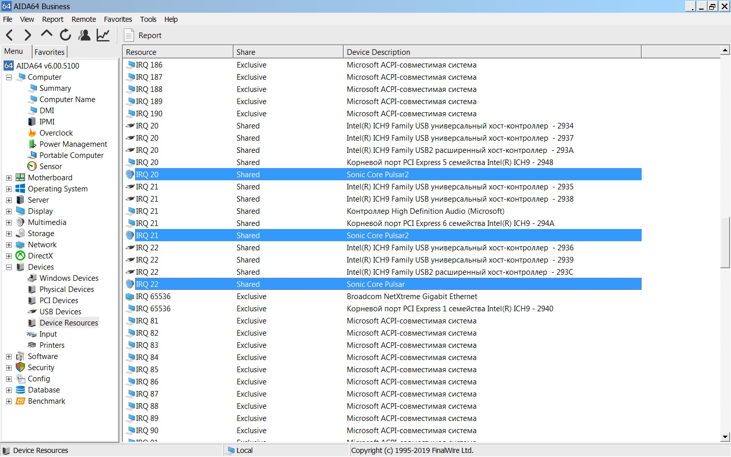

and about irq
Is it normal that cards on Shared IRQ's?
				- irq.jpg (391.41 KiB) Viewed 10114 times
Looks like you´d have to deactivate lots of (or as many as possible for your work) USB controllers in device manager and for IRQ #20,#21 and #22.
MS HD Audio om IRQ #21 is a canditate too.
I disabled HD Audio (Bios-Security-Device Security)Bud Weiser wrote: Wed Jul 03, 2019 8:55 amLooks like you´d have to deactivate lots of (or as many as possible for your work) USB controllers in device manager and for IRQ #20,#21 and #22.
in bios all USB controllers set to IRQ 10. 11 and 5 ( Advanced - PCi Devices), it means they use these IRQ's or, all the same, 20. 21.22 ?
you cannot manually set irqs in windows.
GaryB is correct, the modern HAL is ACPI and stacks most external i/o devices on 1-2 IRQs, and lets the APIC controller figure everything out below that layer.
On a technical level, those are basically "masking" interrupts, which map to low level interrupts in the (BIOS/EFI) APIC/ACPI layer but the OS calls the masked IRQ and allows the hardware layer (EFI again) to determine when a resource is free. Ie, they are REMAPPED to only a few high level IRQs, and you CANNOT control that side of things. This is really necessary on LATER generations (everything from Nehelem/Intel 2009 era onwards) as more and more of the system is managed directly in the CPU itself. You'll also find that disabling sleep states and so on for everything post Nehelem becomes more complex as well, as that was the year that the Power Control Unit was moved onto the CPU itself. This was a good thing however, for on a modern 8/9th gen Core (i) Intel CPU we have very few issues like we had back then with realtime i/o like low level stremaning-data audio & video performance.
In the *very* old days, hardware makers would simply publish slot/resource sharing diagrams in their manuals, but as more and more complexity has been introduced this is hardware to present in a simple table, so doing this yourself once hardware is installed is necessary. What I did on systems before the modern 'i' series (i3/i5/i7) such as yours, was DISABLE the ACPI controller in the BIOS and then boot into something that has ACPI disabled for an OS, and map out all the hardware sharing at that point. Again, you'll have a harder time finding an old enough OS to do this, but I still keep a few ancient Debian based Live CD's (and USB keys) around, plus the odd XP installer. Once you boot to a non-ACPI environment, it's simple to see what your card is sharing with, and move things around accordingly.
Once I have all that taken care of, I then set the BIOS *back* to ACPI mode, and begin my OS install. For any OS prior to Win10, your HAL (Hardware Abstraction Layer) is mapped out at this point (barring major hardware changes that will cause this to be rebuilt), and if you have isolated what interrupts are masking through to multiple devices as mentioned above, you will find you have much smoother performance. Win10 is flexible enough that you can actually rebuild the HAL at any time, and it will sort everything out. But that's not as relevant here..I simply mention it in passing as it not only makes restoring from a backup image easier, it also means it's much more tolerant to major hardware changes without needing a reinstall than prior Windows OS versions.
Pre-Scope 7 it was rather important to ensure that your PRIMARY Scope card (the first one in the DSP meter) was 100% free of sharing resources with anything, but I've seen GaryB report that this is less of a concern with V7. So I will defer to him on that point, but personally I still set my primary card in my cset.ini file once everything else is sorted out.
maybe in this way?
Pulsar2 (Primary) - IRQ 20
Pulsar2 - IRQ 21
Pulsar1 - IRQ 22
I have two USB devices that are constantly on - mouse and midi keyboard.
I can connect them to USB ports, that use IRQ 22, and 21, 20 will free.
other usb devices will connect as needed
