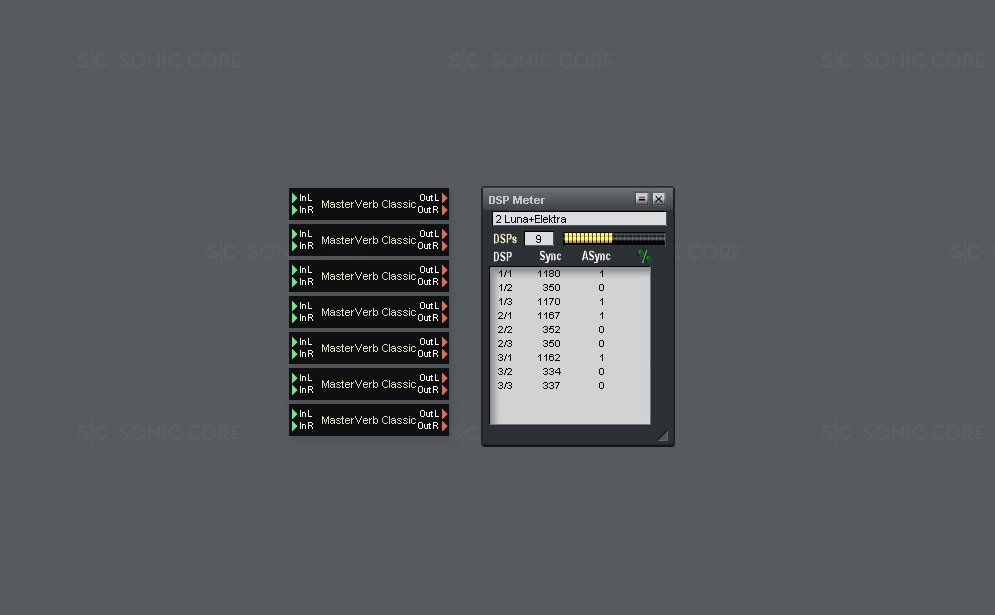

Re: PCI capacity limit
Yea, true.
I have this computer with 1155 chipset, 3 x Luna II installed and Scope 5.1, but it's not my main audio workstation computer,
so i'm using it mostly like add-on setup synced to my main computer.
Here's my Reverb test for 1155 chipset.
7 reverbs, after 8 - pci limit reached
- Untitled.jpg (50.82 KiB) Viewed 4242 times
