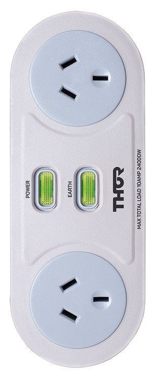

Im looking at this at the moment : https://www.thortechnologies.com.au/product/smart-duo/ which has EMI/RFI noise filtration. Would this do the trick ?

@gary - no idea about the building grounding. However, this little THOR baby did the trick for $109 - mic signal clean as a crystal in space.
