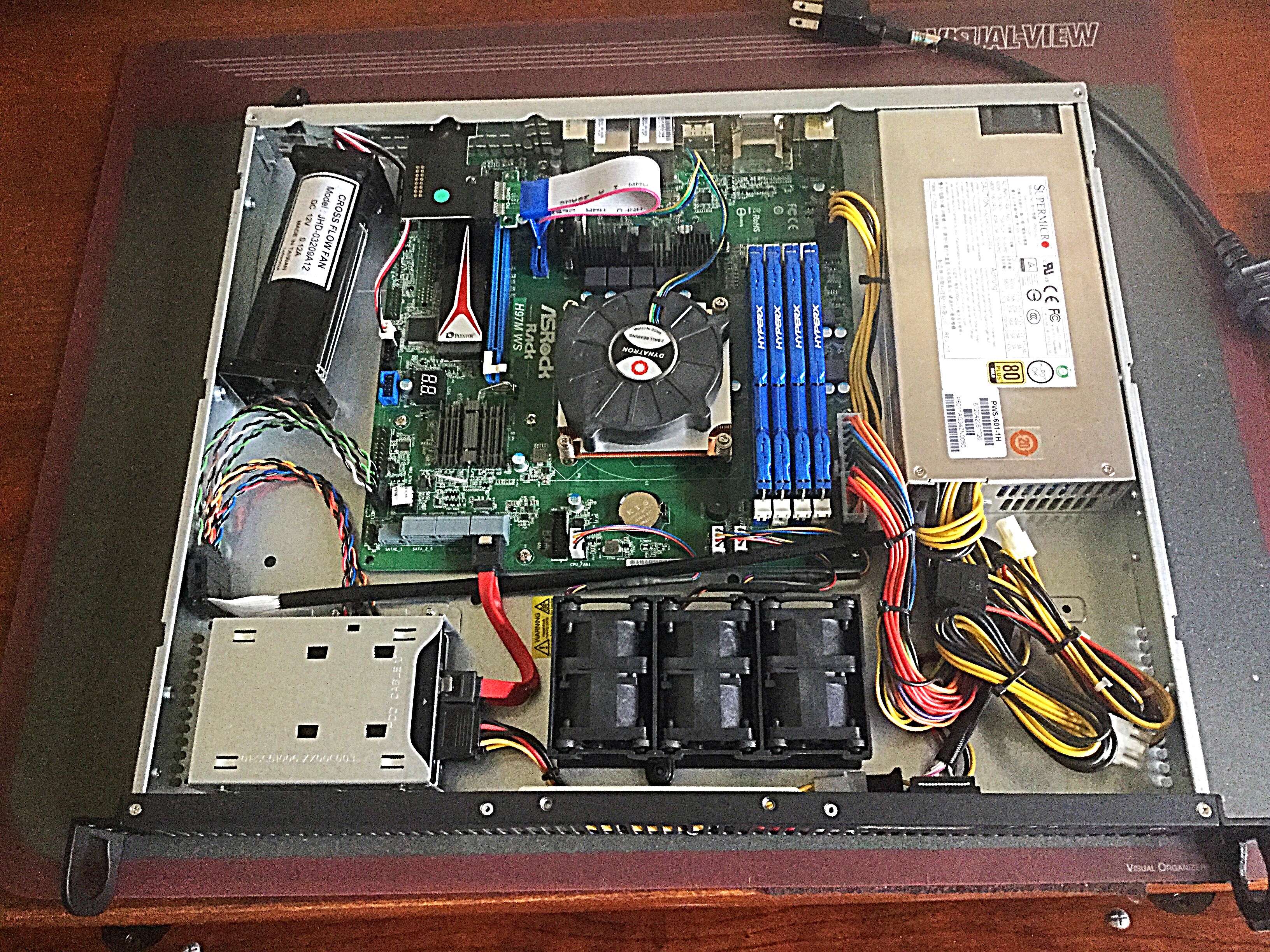

Sure.
Supermicro CSE-512f-440B which is a 1U ATX Chassis
i7 4790k
ASRock anything Z or H97
32GBs Of DDR3 RAM
Samsung 850 Evo SSDs.
That’s about it.

wow! great! And you have a box for your scope through pciex-to-pci adapter, is it correct?
Re: Micro ATX PCI expander
no, he has an XITE-1 which has a connector in a PCIE slot.
external PCI expansion boxes don't work well.
also, as you can see, he does not have a bunch of dsps inside there and he still needs to be aware of heat. 3 space minimum for a PCI card is a good idea.

garyb wrote: Thu Sep 13, 2018 9:03 pm no, he has an XITE-1 which has a connector in a PCIE slot.
i understand :( perhaps i will have no alternative to move to a bigger case, although it's heavier and bigger...
Thanks garyb and dawman!
