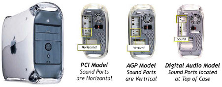

@ astroman: I will certainly keep the G4, like I did for all these years. Besides the noisy fan, it works at best and Scope rocks in it. In there I have the lowest latency ever (ULLI 3ms). So worst case scenario, if everything fails, that is a certitude until also its natural life will expire.
The G4 is a graphite one (white/transparent and blue - and it really looks as new as in the pic), the exact model I do not remember, as it is not with me at the moment. It must be either the PCI or the AGP in the pic:
mac os 9 lives005003.jpg (23.62 KiB) Viewed 10413 times

alberto wrote: Thu Dec 28, 2017 10:01 am I will certainly keep the G4, like I did for all these years. Besides the noisy fan, it works at best and Scope rocks in it. In there I have the lowest latency ever (ULLI 3ms). So worst case scenario, if everything fails, that is a certitude until also its natural life will expire.
There was also the G4 Gigabyte Ethernet dual (G450) ... that´s what I have in stock in excellent condition.
I kept it to load/read old Notator SL and Logic 4. files into the latest Logic 6.4.3 being compatible w/ those files.
This year I put in Alex Hilton´s Jamport http://alexhixon.com/projects/jamport/ allowing usage of non-USB MIDI interfaces like my MOTU MIDI Timepiece II or Opcode Studio 64X.
Works great !
I never used SCOPE on a Mac before, so just by interest ...
What was the latest SCOPE version working on Powermac PPCs in MacOs v9.2.2 ?
Which devices were included in that version ?
When I have SCOPE 4 / 4.5 / 5.1 and v7 for my PCI card and WinXP - 10, is it still possible to find Mac installation files and getting keys for Mac ?
Which were the minimum system requirements for SCOPE on Mac PPC and which were the recommend system requirements ?
Is there any information available worth reading according to SCOPE running on a MAC PPC in OS9.2.2 ?

The best safe bet is the Powermac G4 Quicksilver model at around 800 Mhz single (!) CPU.
Dualcores are notoriously asking for trouble in OS9 audio.
While the MDD model is a bit more powerful, it can be very picky with it's Ram. Even if it doesn't fail and passes all checks, it still may trigger errors of the most strange kind. These are really convincing fakes of application error messages, so don't be mislead. ;)
A G4 500 is a valid machine, I've installed Scope 3.1 once on a G3 (now occupied by Pro Tools), without problems.

Well, I´m not sure about this because AFAIK MacOS 9 doesn´t support multi core/multi processor usage.
So, I´d might end up w/ only one core in use while the other idles,- and then, 450MHz per core might be not enough CPU power ...
That´s what I can imagine though ...

astroman wrote: Fri Dec 29, 2017 2:38 pm The best safe bet is the Powermac G4 Quicksilver model at around 800 Mhz single (!) CPU.
O.k., that´s what I feared !
On my G4 Gigabyte Ethernet Dual G450, I have TWO Mac systems running,- OS9.2.2 and OSX 10.4.11.
OS9.2.2 is for Sounddiver 3.05 as well as Emagic Logic Audio Platinum 6.4.3,- and OS X 10.4.11 runs several other apps and Emagic LAP 6.4.3 as well.
At least Space Designer in Emagic LAP 6.4.3 introduces GUI issues in MacOS9.2.2 but not in OS X 10.4.11.
OTOH, Emagic managed LAP´s audio engine using one (1) core in MacOS 9.2.2 and the MIDI engine using the 2nd core.
So I wondered,- if SCOPE SFP was able to use 1 core exclusively and the other was still for Logic and MIDI then,- but that´s only a guess though.
