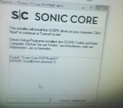

I am trying to install Scope 5.1 on my new computer: socket 775 core2duo with win8 64bit, but I am getting this message. I am using the latest install kit downloaded from the website. On the same computer I had win7 32 bit and it worked..
Any idea?

Have you disabled driver signature enforcement?

right click command prompt "run as administrator",
copy - paste:
bcdedit -set loadoptions DISABLE_INTEGRITY_CHECKS
bcdedit -set TESTSIGNING ON
restart windows
install drivers for scope
and then turn off :
copy-paste:
bcdedit -set loadoptions ENABLE_INTEGRITY_CHECKS
bcdedit -set TESTSIGNING OFF
restart windows
geiger
Posts: 52
Joined: Sat Feb 18, 2017 2:55 am
Location: Bucharest, Romania
Re: Win8 error driver install message
Post by geiger »
I worked like charm! Thank you!!
