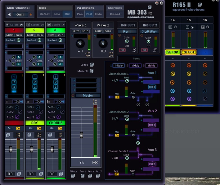

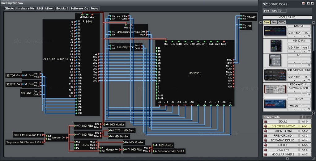

I’m familiar with Modular Mixers.
Use Routers and Master Bus.
On Mod V2 I just can’t get AUX 3 to respond to the externally connected FX.
AUX 1/2 work fine.
Plus I’m using the 2nd & 3rd Bus In’s to correspond with knob 1 (dry) on Router, and knob 2 (chorus using insert),
AUX 1 (knob 3 on Router) is external TC Fireworx.
AUX 2 (knob 4 on Router) is external DSP Delay
AUX 3 (knob 5 on Router) is external DSP Reverb.
All works fine except AUX 3 on this particular router / Master Bus combo.
Even using no ext option on AUX 3 and inserting the effect shows signal but no effect can be heard. I’ve isolated AUX 3 over and over and no joy.
Could you look at jpeg and maybe see if I’m doing someth8ng wrong?
Same settings used on AUX 1/2 and they work.
The effect itself works as I used it in WAV In 1 as an insert and the effect is applied globally.
But I lose per instrument control.
Ankyu....
AUX 3 Master Bus 303FX

Thanks Jimmy,
I attach a correction. The aux 3 levels were off after the aux return vu-meters in 303 and 503 Fx...
Could you please let me know if it is fixed for you ?
I will upload 503Fx later on...
- MB 303Fx.zip
- (890.12 KiB) Downloaded 627 times

Re: AUX 3 Master Bus 303FX
Hi all,
There is a new zip on the ftp
V 2.01 ( 11. 21. 2017) (21 Nov 2017)
- Midi CC in Inserts: CCs could not be assigned to inserted effects. fixed, now all work as expected.
- Template preset button could sometime become unselectable. Fixed.
- Master Bus Aux 3 seemed to work but remained mute: fixed.
- Various graphic improvements when it could be confusing ("Gain" labels on channel input gain, because they were often confused with the color selector button, MB 502 Aux section moved down... other small stuff).
If you downloaded previous version, please download and install the new version, overwriting the previous install.
