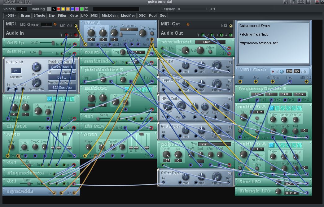

But Faxi Nadu's patch guitaromental could do the job too, isnt it?
