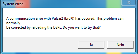

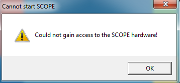

Hi,
Scope 5.1 software does not start anymore (Win 7).
Gigabyte G41MT-D3V
http://forums.scopeusers.com/viewtopic.php?f=1&t=34976
Reinstalled software and driver. Doesn`t work.
If the card is dead, are there any values to compare it with another card - especially the A-D converter (Sound quality)?
Many thanks
Re: Hardware Problem Pulsar2Plus
find another Scope card and write support for a keyfile for the new card. you'll have to return the broken card to get v5.1 for free on the new card, but there sure as hell isn't anything else new made that offers the same quality for the same money as a used Scope card.
