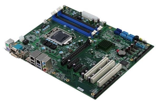

Re: 3 pci mobo + CPU combination
http://www.aaeon.com/en/p/atx-imba-q77

Hello Dawman - Nice mobo with 3 x PCI slots and 2 x PCI-e 2 x1 slots - Great for PCI cards and Xite!
