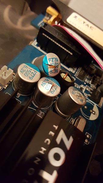

Re: Help ! Has my old faithful Pulsar 2 finally died ?
Yep...look like this...is on a gfx card, but this is how those bastards look.
- burst caps.jpg (56.83 KiB) Viewed 7311 times
