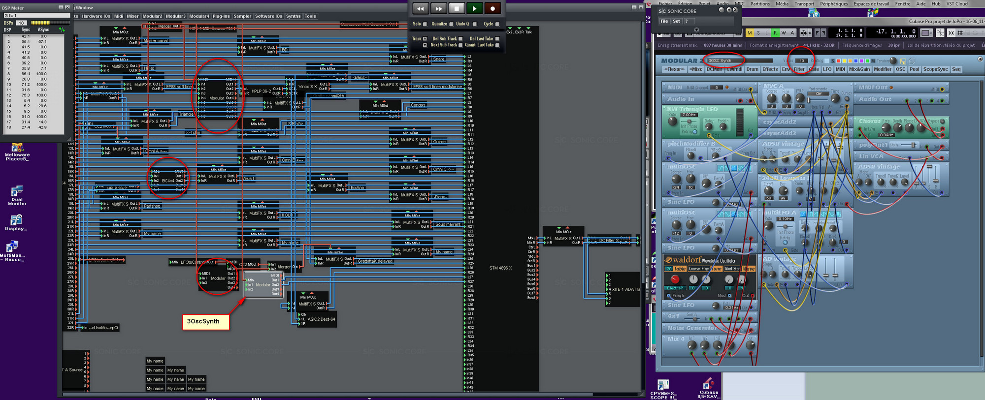

Ok. I made the test. I loaded 3OscSynth and changed one of the oscillator with the Waldorf one. I made that in the project I'm already working on. I assigned 10 voices to 3OscSynth without any problem or error message. As you can see in the jpg, I already have 3 other modular patches in this project. Each stereo channels going in the mixer have a multifx rack with different fx processors in them. In one multifx rack, there is 2 other multifx rack, like russian doll !! And you can see the power meter is far from its maximum : it's around its middle.
Maybe the issues you are experimenting don't comes from Scope & Xite, otherwise, I would have the same. Maybe it comes from your computer or something else than Scope. Why wouldn't I have the same issue than you ?
I don't know what problem it could be. If you didn't already, tell us which MB, windows, in one word config you're using and maybe we'll find what is the problem. And if you bought an Xite-1 just for having " hardware VA/Wavetable synth that I could build up to my own specs in a modular environment" it's a bit like using a bulldozer to plant tomatoes. And that's right : you can use VST's to have similar patch, with Reaktor, for instance.
I really wish one find your issue for you to fully take advantage of your Xite. Because patches like 3OscSynth, here, I can load maybe 6 or 7 with 8 voices in each. But believe me, here that patch works pretty well as you wish, there is necessarily something else.

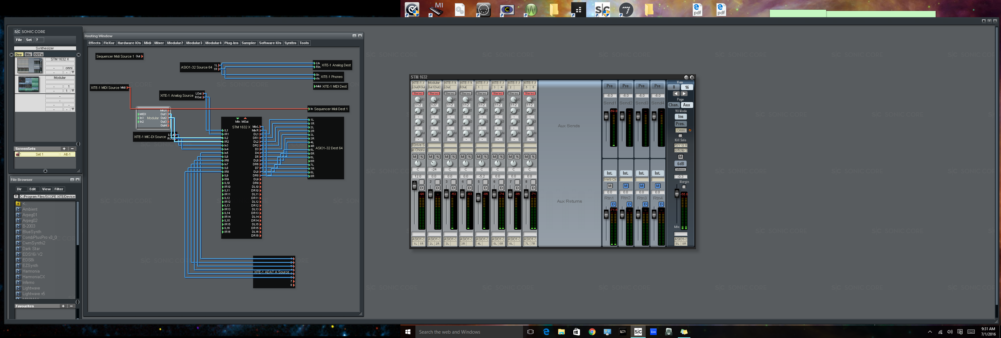

haha hot damn jopo! thats one serious project window :0 <3
Music
Re: Modular losing voices.
:) ! Thanks, Faxi !
I wanted to say also : except asio i/o modules, none of the other modules in the project have been assigned to dsp. I tweak dsp assignment only when I get an error message.
But asio i/o have always to be assigned to DSP 2 ! That's important and since I do that, I don't have any error message often. When I had my Xite, I used to load fx processor insets in the mixer. And I had a lot of error messages. It's much much better for DSP power optimisation to use multifx modules outside the mixer (or other device) as on the jpg.
And this is why I made a Scope project template with all those multifx modules, already wired to the mixer and with text modules ("My name"), offered by Fra77, close to the multifx outputs to find back my children. The asio -> multifx -> mixer channels where is still "my name" written are not yet in use.
You can see the asio 2 dest module wired to the bass chain in order to record only bass before mixer while listening all. When you want to record anything, you just have to wire the asio dest module at the output you want to record. You can see HPLP 36-2 filter at the sidechain of a Vinco compressor and asio source module 32L, 31R & 31L wired to modulars for audio resolution modulation thanks to Silentway modules in Cubase --> ultra-précision & perfect timing. The EP88 soft tine channel is the last UVI electric piano sample library (really go0OÔÔOod !) that I can modulate each notes (in this case chords) thru the 8-8 IO modular IV. I builded some kind of tremolo / special autopan that is modulated by Silentway : depth increase or decrease thank to Silentway envelopes on each chord. This fx audio processor that woks synchronically with midi doesn't exist on the market, believe me ! :D

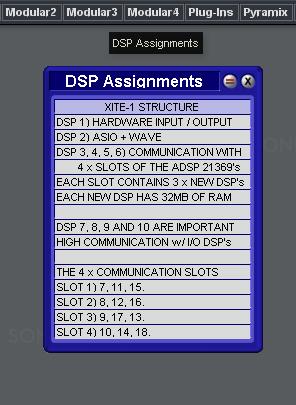

!! Si ! Che uno grosso problemo !! You get error messages with this project ?!
Dsp 2 is in Xite for asio. Don't ask me why asio is not automatically assign to it but if you do so, it will help. Dsp 1 is for hardware i/o, so you can assign them to dsp 1. Those 2 dsp are the only ones I assigned in my project template and there assignment is stored with the project file.
DSP assignment.JPG (30.67 KiB) Viewed 6746 times
You'll find more details in this note :
Dsp assignment.rar
(1.22 KiB) Downloaded 293 times
Then one has to find your computer issue and I don't know nothing about all MB on the market, I just know there is some good chipset for Scope and some not good. What is your MB chipset ? If your chipset belong to the bad ones, you'll have to change it !
Did you try to change the Xite pcie card slot ? You have to search / try different things... Maybe disable usb ports you don't need. Disable any system for electric power saving, disable system that can change pc cpu frequency... You can find all you must do here, on Z... Gary knows ! Gary ? Can you show us the tips link ?
That's good news ! That means it's not Scope / Xite fault but your computer and one can fix that. There is the possibility your Xite has a malfunction but I'm sure the manufactoring quality is very good but if after all the problem is still there, that might be the Xite. In this case, you'll have to send it back to Germany for reparing. But when you'll have find what is the problem, you'll see all what you can do with your S|C gear. The project you show us will be a small part amongst the rest...
