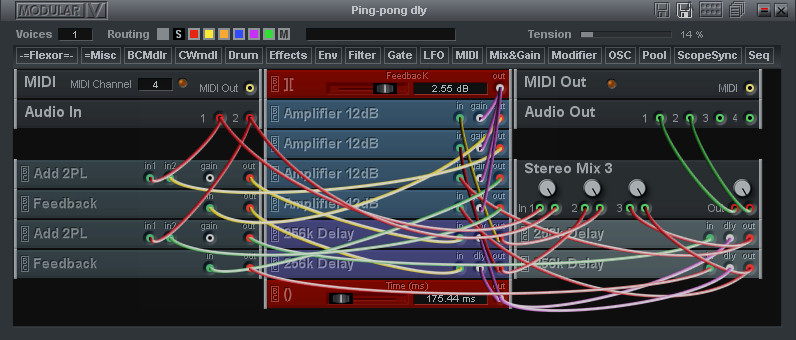

Ping pong delay are often not really ping pong... For instance, all Scope delay are not able to really L/R delayed. If you listen, you'll hear one on 2 delay completly on one side...
Vst's ping pong often work in ping pong but if you send it a completly left sound, the 1° delay is on the right, ok, all good. But if you send it a completly right sound, the 1° delay is also on the right !! And for me, that is a betrayal.
So I made that one, you can add filters easily in the feedback path. It's as simple as possible. It always put the 1° delay on the other side of dry signal side. BCmodular needed.
