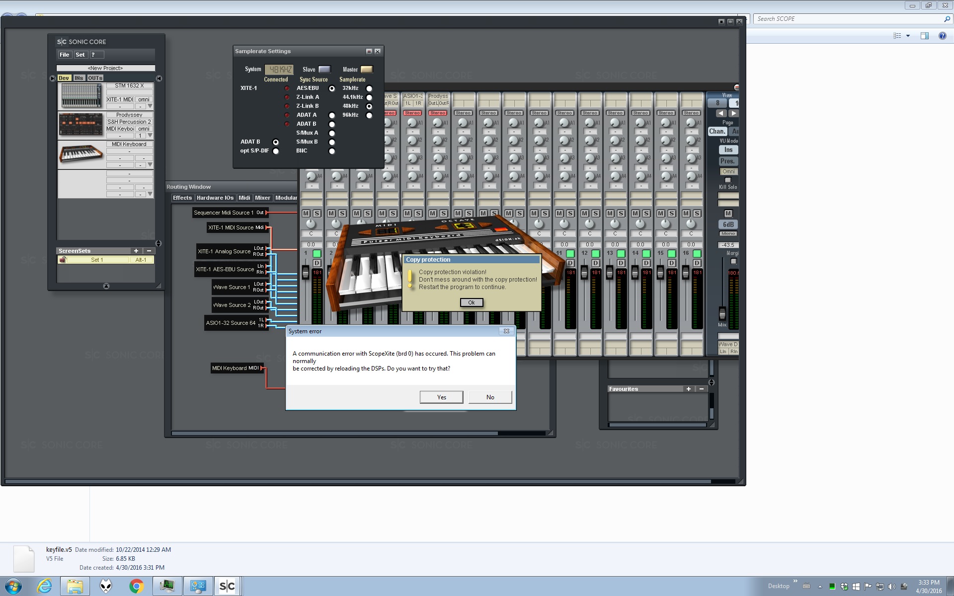

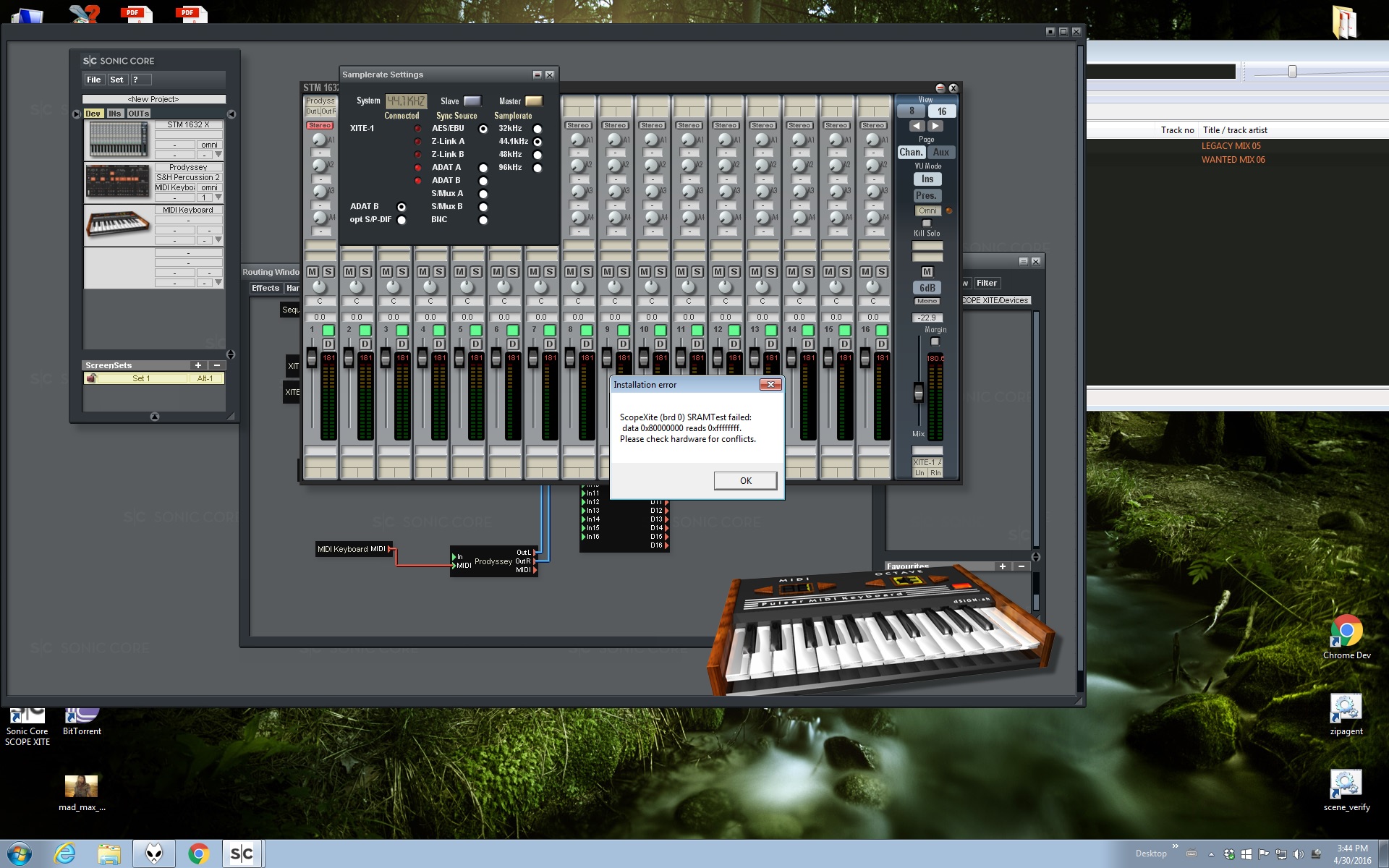

After a long hiatus in production I finally dusted off the xite (metaphorically speaking) and got back into the game... to find out at my dismay that I can no longer use it!! It seems to work for a about a minute, a little noise however than than a series of dialogs creep up (ie. copy protection, pci overload, dsp overload, bad stram) until I'm forced to quit, restart my machine, and try again for another whopping minute :-?
I've attached a couple of screenshots descibring my issues. For any help, last time I worked on Xite I was using the SDK. I completely (to my knowledge) uninstalled the old SDK drivers to put the ones in the SCOPE installer (11/23/2010 5.0.9.5), I'm running Win7 x64 (didn't prevent me from using the Xite completely, just certain functionalities), cleaned the registry, removed all usb devices.

that warning means what it says, there is bad ram on the XITE's board.
this warning MIGHT be triggered by a poor connection either with the HDMI cable or the PCIe card. you can reseat the card and the cable and try another cable. if those things don't work, you'll need to contact support for service.
