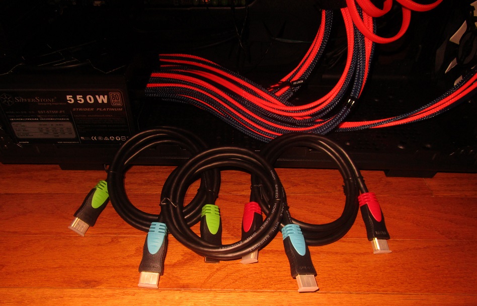

krizrox
Posts: 1330
Location: Elgin, IL USA
Re: XITE/Scope 5.1 copy protection error
Post by krizrox »
My new HDMI cables came in today (I bought a couple different brands just in case). Everything is working. Time will tell. Keeping my fingers crossed lol
