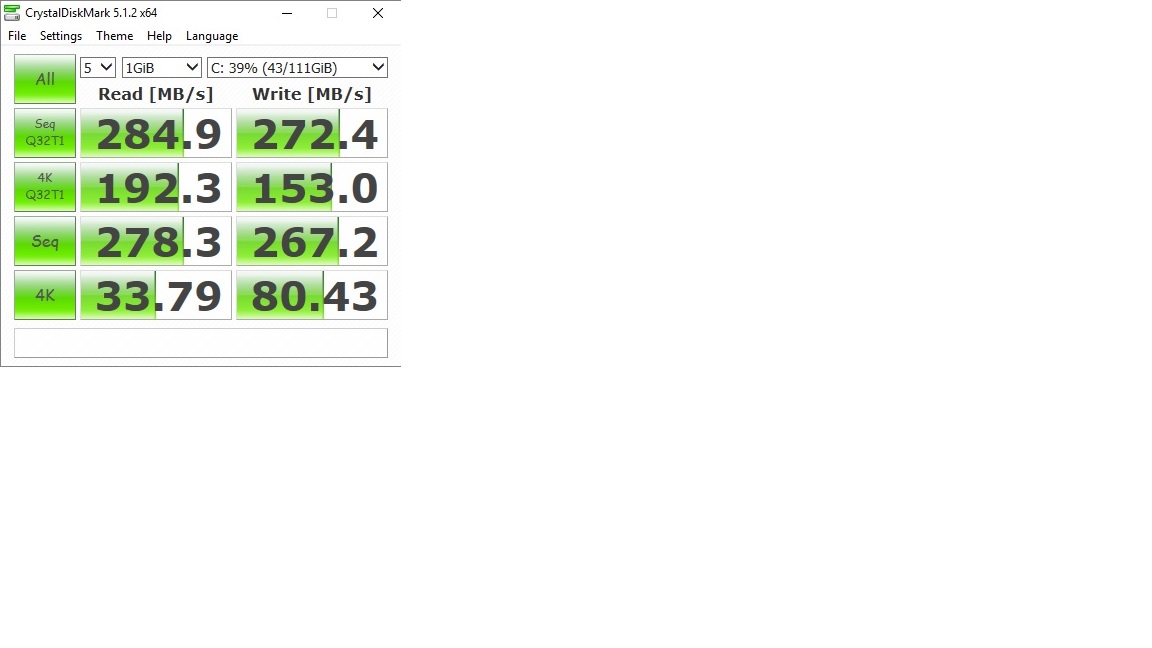

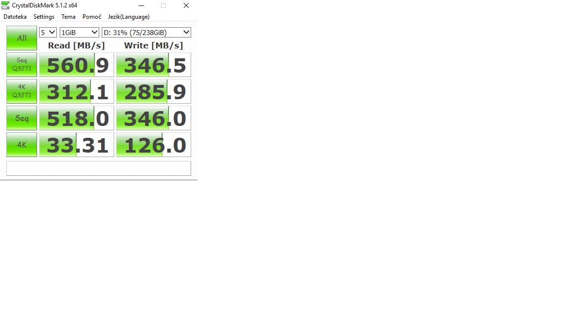

I have tested my ssd's with crystal software.
I have 3 ssd's.
One Samsung 840 evo 128gb is located in this computer, sata II and
other two Samsung 840 evo 128gb and Crucial MX100 256gb in my main music computer , sata III.
I have attached both 3 test results.

Sata II - samsung 840 evo
Sata III - samsung 840 evo
Sata III - crucial MX100
sataII-samsung 840 evo 128gb.jpg (72.86 KiB) Viewed 1285 times
sataIII-samsung 840 evo 128gb.jpg (74.58 KiB) Viewed 1285 times
sataIII-crucial MX100 256gb.jpg (77.12 KiB) Viewed 1285 times
