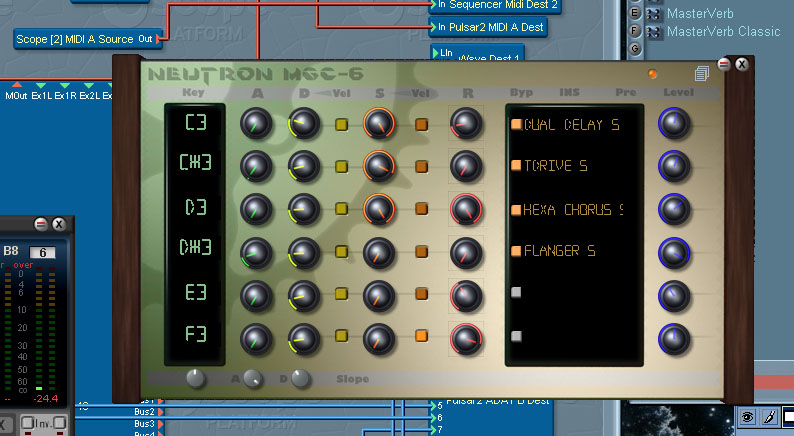

Post by Neutron »
Here is the updated version easier to use.
envelopes behave in a more normal way
nice shroomz knobs
limited range of note selector pot to give easier variation.
once you have set up some effects you could use this to get suprising changes.
how to use:
put it in the audio chain. i like to use it as an external insert.
put some stereo effects in the slots.
send midi notes c, c#, d d# e and f [MIDI NOTE NUMBER 60-65 to turn on the corresponding effects.
envelope is controlled with ADSR in the normal way.
velocity control of level or times can be switched on or off.
this can be used for glitching, gating, ducking, simplifying the automation of track effects.
using different delays in each slot you can get the lower part of the virus atomizer effect. (but better! because its stereo and each delay can be tweaked seperately)
Neutron_MGC_6_06.zip
version 0.6
(746.5 KiB) Downloaded 722 times

Thanks Neutron. Seems good so far. Must say the level control action seems exponential so volume doesn't kick in until it's 2/3 of the way up. The release doesn't seem to have any effect but maybe I'm doing something wrong?

irrelevance wrote:Thanks Neutron. Seems good so far. Must say the level control action seems exponential so volume doesn't kick in until it's 2/3 of the way up. The release doesn't seem to have any effect but maybe I'm doing something wrong?
release will not be noticable unless the effect is time based such as a delay or reverb, or if the sustain and decay is long enough to last until the note is let go.
the volume controls range was just copied from creamware mixer atoms, i could change it easy though.

updated. much easier to use. shroomy knobs.
please see original post
lots of fun!
im thinking of adding more inserts per chan, maybe pre and post envelope (post will be good for dub delays and reverbs)
also have to do the preset list but im leaving it till the device is final.
