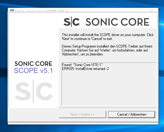

Hi all,
I am trying to perform a new install of Scope 5.1 for Xite - 1 on Windows 10 and I keep getting the message:
Found "Sonic Core XITE - 1"
ERROR: InstallDriver returned - 2
On reboot the hardware is not identified and the software doesn't load.
Any suggestions?
Re: Windows 10 Driver error
google "disable driver signature enforcement windows 10" and follow the instructions before trying to install Scope. there's nothing wrong. win8 works the same way.

...............that did it!
