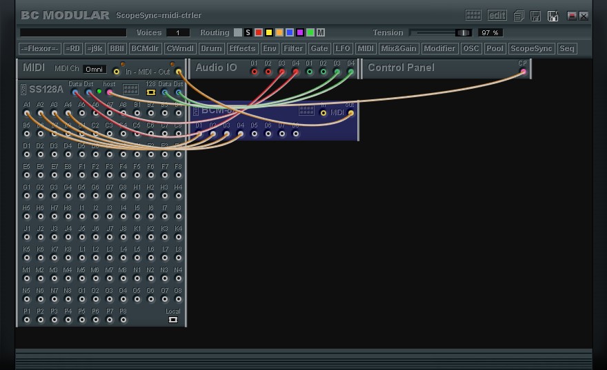

With that kind of simple modular patch, we already can transmit automation data via audio input, then convert those data into midi data and link them to any Scope device midi input...
That is already excellent. But the USAMO box is an awesome idea : you have a vst instrument, that means totaly normal midi tracks (and automation tracks if one wants) for editing midi cc and no midi jitter ! :o
http://www.expert-sleepers.co.uk/usamo.html
I'd like to ask to ScopeSync team if it would be possible to make a ScopeSync vst instrument device ? As we already have the ScopeSync audio insert vst plugin And have a vst instrument in our DAW that send midi data (notes, midi cc, pitch, ...etc...) on several midi channels to Scope ! In that way, all our midi timing issues would become less boring.....? :)

Great ! I'm very impatient ! If it works like I imagine (see my post with the modular patch jpg), ScopeSync will definitely reach its "mature" state.. And I believe it should increase interest for every body using Scope !
