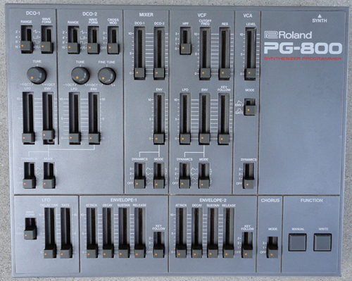

I did last week, a new bios e-prom used in my old Roland MKS 70 (1986)
now he can send/rec midi-ctl over the pg800 and seq and many many more...
...please don´t forget to support the good old 3rd party developer.

ps.: ok, mks70 new bios e-prom not from Roland, from a technic-freak
