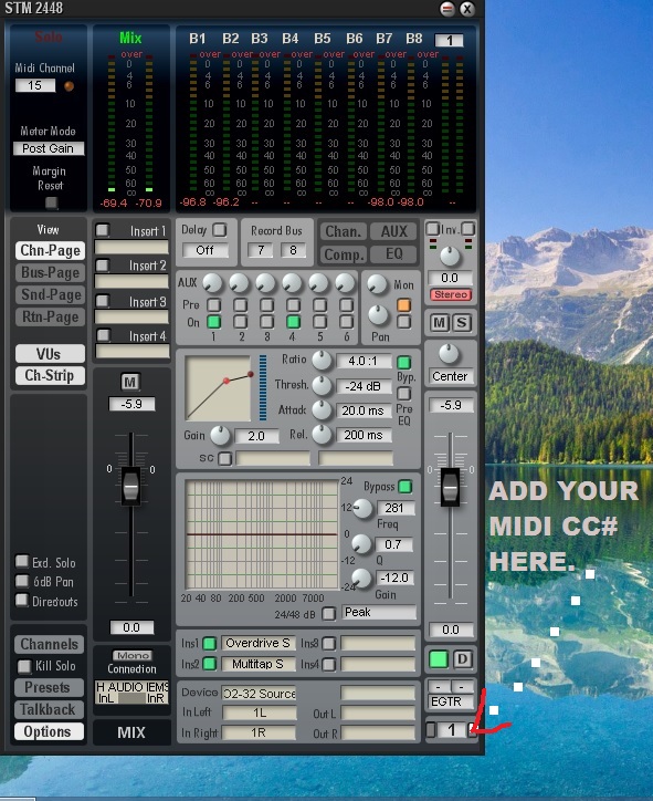

Who says you can't teach an old DAWg new tricks..?
Right clicking on the channel number brings up a MIDI CC window, so for shits and grins
I thought I sure would like an easier way to go directly to a Channel during a gig and
make any adjustments to the AUX Channels, Monitors while staying in the recallable
window I program and edit in.
On my Physis K4 I can assign a knob, slider, pedal, button, any controller I want.
But it has a STEP feature I really like. So I adjust the range and by tappting a button can
cycle through the channels so they just use 1-16, as I do not need 17-24. So it just clicks
right through to the channel I want.
Works like a charm, don't know if any of you cats can use this, but it sure beats mouse clicks.

Is this a full work-a-round for the problem of STM only receiving on one channel (therefore not enough CC's to cover all controls) ?
A BCF2000 could send a 'change channel' message - eg 1 - 4 to STM. Effectively an 8 slider BCF could control 32 sliders on STM - would that work ?

JV; I've done that exact same thing with my Novation Remote SL and it works great. I set my channel scrolling to one of the endless rotary controllers though instead of a button, seems to me a lot quicker to zip thru the channels. You may have those already assigned to something else though.
Your latest rig didn't show any BCF/BCR so I guess it's one of those things to keep everything portable you have to sacrifice having well.....everything :lol:

Actually I have a Physis K4 using STEP mode and a footswitch.
It cycles through 1 to 16 as I don't use more than that.

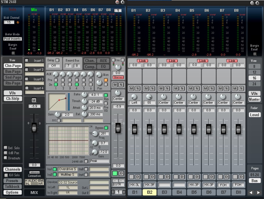

Here's a couple of new tips for the STM Mixers.
Really prefer not touching the mouse at all.
So I save 2 x screensets for the Bus Page and another for the Channels.
When calling up the Bus page I can scroll through the AUX sends/Returns and Busses.
Just assign a fader/knob and go left to right.
Also I prefer selecting 16 channels to view instead of 24. 8 also works if more
screen real estate is needed.
But a screenset recall of the channel page allows you to scroll through the channels now.
That same MIDI CC# assigned to the lower right channel also allows you to view Master
Channel page only too using a 3rd Screenset.
Now you can view each master channel with AUX sends in a Master view only page.
If you really want to get assign the view buttons for window size each to a CC# too.
8 channels MIDI CC#98
16 Channels MIDI CC#99 and so on, etc.

My favorite view for live work.
Each Bus pair requires a single CC#.
Scroll or Step (Physis K4 Step Mode) through master
channel view.
AUXs have CC#'s too.
