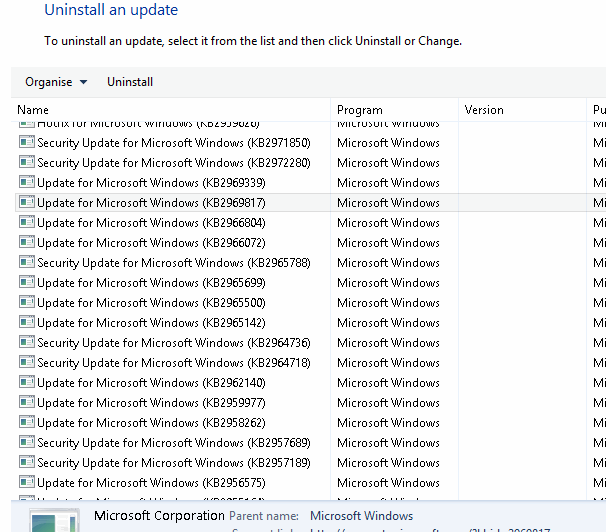

KB2919355 can be uninstalled! go to add/remove programs, click "view installed updates" (at upper left), and use search situated at top right corner, search for (KB2919355).
If you don't do this you are going to have not only non working sampers, but VDAT as well and it gonna give you blew (actually dark purple now) screens!
If you keep getting file not found errors, check if those files exist and if the attributes are proper. Also it can be something to do with dsp files not loading under 64bit system as some plugins are not compatible and namely dsp files are to blame.
Re: Windows 8.1 64bit Scope 5.1 "Can't find DSP file..."
It cannot be uninstalled if you have a Win 8.1 DVD that was created after the patch was built into the base install.
Fidox, has this install. Other users (such as myself) do not.
If you know where such an installer (Win 8.1 pre April update 2014) can be downloaded, please point me to it.
Watch the 'Uninstall' link ( next to the word 'Organise' ) dissappearing when the KB2919355 is selected
no_uninstall
no_uninstall
fidox
Posts: 850
Location: Slovenia
Post by fidox »
well, i have Windows 8.1 Pro 64bit version on my DVD (burned from ISO filo) before spring update,
and if you think that could help, i can make ISO file and upload it somewhere ...
