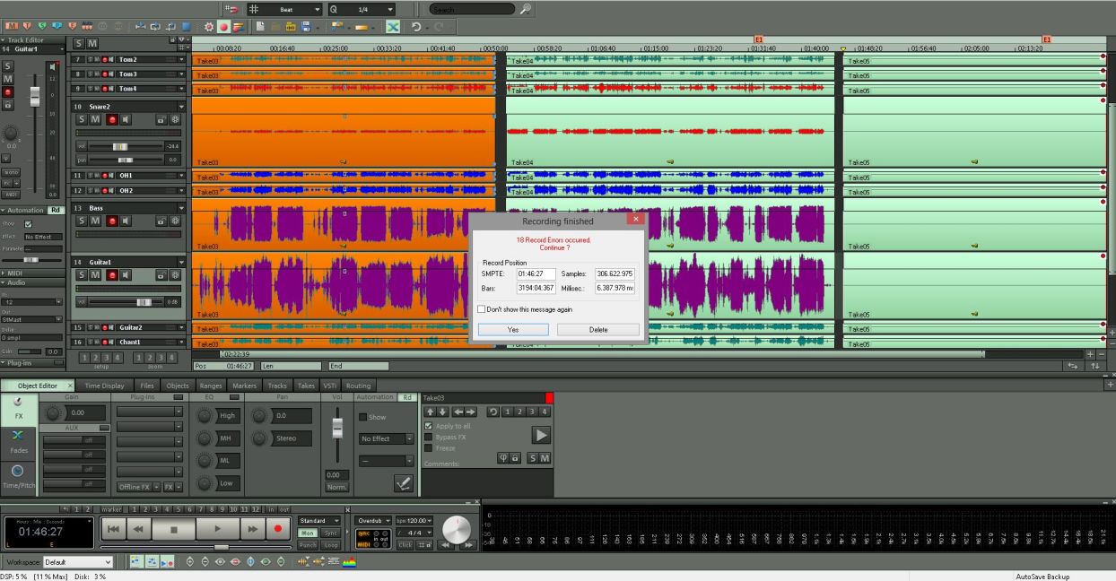

edit:
I just made some tests with only the computer and xite open (no converters), and the results is there:
then i think converters and sync are not in cause.
